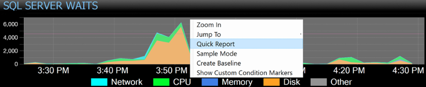

I highlighted that time period on the Dashboard, and right clicked to create both a Quick Report and a Baseline:
Figure 2 showing how to create reports and baselines from the Performance Advisor Dashboard

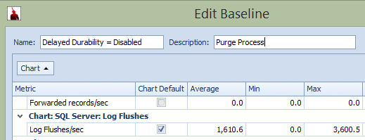

I used the values calculated in the Baselines and Quick Reports for my comparisons:
Figure 3 showing values calculated for the Baseline

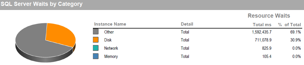

Figure 4 showing values calculated for the wait stats via Quick Report

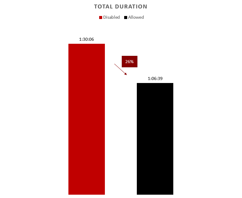

The purge process that I tested in this example had multiple transactions that required a change to commit with Delayed Durability set to on. As shown below, the process took about ninety minutes to complete when Delayed Durability was Disabled in the database and approximately sixty-six minutes to complete when Delayed Durability was Allowed and turned on for specific transactions.
Figure 5 showing Delayed Durability providing a 26% savings in total duration
As one would probably expect, there is a very similar percentage of savings between duration and disk-related waits when using Delayed Durability. If you have these types of waits during your purge process, then it is possible that this change will assist in reducing them.
Figure 6 showing Delayed Durability providing a 25% savings in disk-related waits

There is also a 48% decrease in the average number of transaction log flushes per second when delaying durability.
Figure 8 showing Delayed Durability providing a 48% savings in average log flushes per second

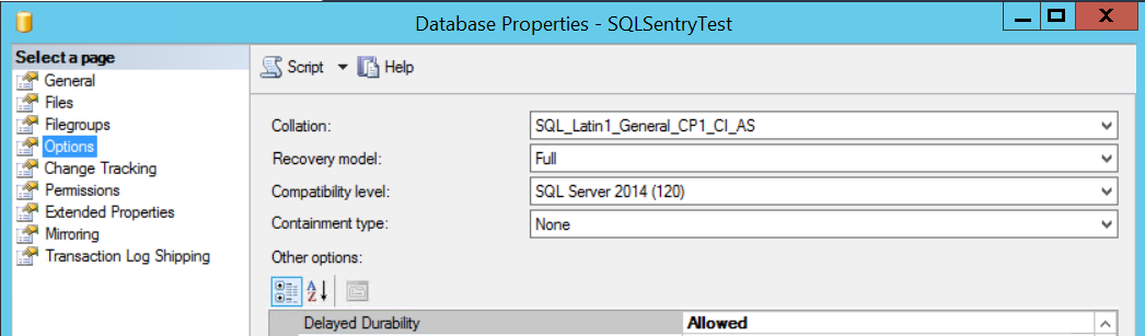

ALTER DATABASE dbname SET DELAYED_DURABILITY = ALLOWED;
Altering the database options
This may also be changed or checked via Database Properties --> Options in SQL Server Management Studio.
Figure 9 showing Delayed Durability setting in SSMS

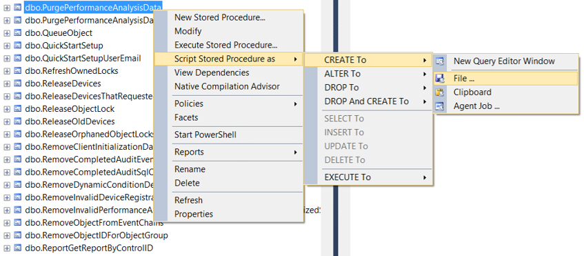

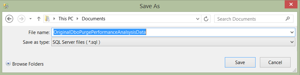

The stored procedure that we'll be altering in this example is called [dbo].[PurgePerformanceAnalysisData]. This particular purge process was chosen based on its transaction log usage pattern and observed benefits when allowing Delayed Durability. You should make a backup copy of this stored procedure before proceeding. You could do this by right-clicking on the stored procedure in SSMS, and choosing to "Script Stored Procedure as" -> "Create To" -> "File" to create a script of the original.
Figure 10 showing how to send the stored procedure to a create file
Figure 11 showing the save file dialog for original stored procedure
