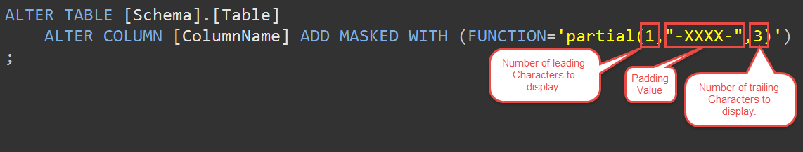

partial()
partial()
is the most user-configurable of the functions available. When configuring the masking function, the number of leading and trailing characters of the string with a custom padding value in the middle.

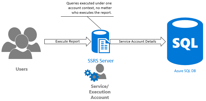

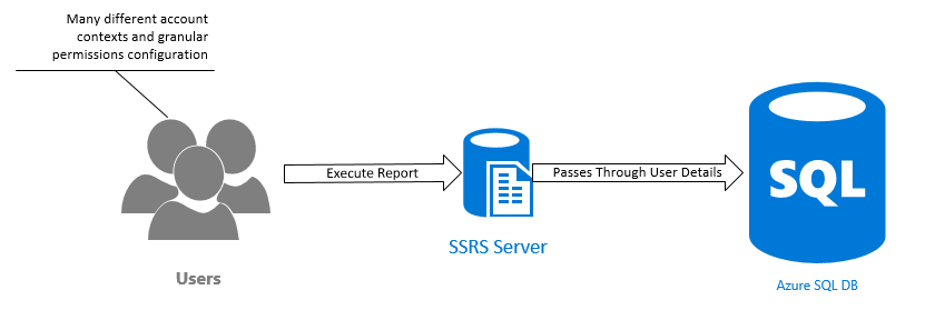

As the Dynamic Data Masking feature is built around the existing SQL Server security model for logins and users. It is important to understand how these users will be connecting to the database or whether the execution context of the queries is being set at execution, via EXECUTE AS. The first hurdle in our scenario is going to be, how we handle the data source configuration. Here we need to think about the fact that we have two collections of users: some that can see all data, and others that will see masked data.

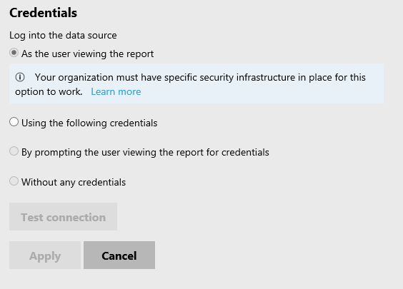

The options for setting SSRS Data Source security Credentials are as follows:
In this situation, the only two options that are really open to us are "As the user viewing the report" and "By prompting the user viewing the report for credentials." The reason being that if we specify an account or use the Execution Account, then we cannot discern whether to display masked or unmasked data. These two potential configurations are seen below:
SSRS Configuration 1.
SSRS Configuration 2.
Note! -- In theory, it would be possible to use the second configuration. Though this would then require that a user mapping configuration is created and maintained. This could then be used to identify who should see masked and unmasked data. Creating two database users, one for masked and the other for unmasked query execution, then using EXECUTE AS for the statement, which can then return the appropriate results.
