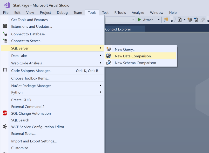

Visual Studio
With the power of Visual Studio and SQL Server Data Tools, you can perform a data comparison directly from within the application. If you’re familiar with the Visual Studio interface, this might be an easy solution to discover where data gaps exist within your databases.
Figure 1—Example of starting a Visual Studio data comparison
The image in Figure 1 is from Visual Studio 2017, but any supported version of Visual Studio has this functionality.
