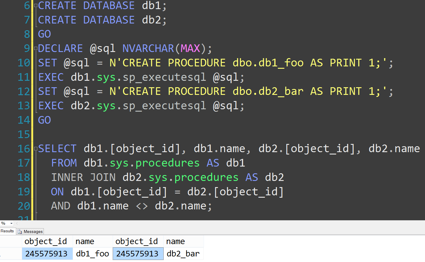

This returned stored procedures that he was sure weren't being called, and validated via trace. The reason? He was running the stats query from the right databases, but had procedures in other databases that *happened* to have been assigned the same object_id
. While many people assume object_id
for user objects will be unique across an instance, on my system, I was able to reproduce this scenario quite easily:
Same object_id, different names
Then I executed only the stored procedure in db1
EXEC db1.dbo.db1_foo;
GO 100
Now, I imagined that I was actually looking for executions of the other procedure, db2.dbo.db2_bar
