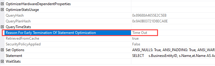

In the execution plan, I can look at the plan property of ‘Reason For Early Termination of Statement Optimization’, which in this case has a value of ‘Time Out’:
This means that during query optimization, there were so many plan options that the time limit for optimization was hit and the “best” plan of the explored plan alternatives was chosen as the execution plan. This happens quite often, and if you have complex T-SQL statements and aren’t getting the execution plan you’d like, it may be time to refactor those T-SQL statements so they involve fewer joins, or break the statements up into separate statements.

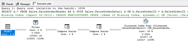

Looking at the execution plan for this statement we see there is a reference to the Sales.SalesOrderDetail table and the Production.Product table but no reference to the Sales.SalesOrderHeader table:
The reason is because there is a foreign key relationship between the Sales.SalesOrderHeader and Sales.SalesOrderDetail tables. There is no filter in the WHERE clause against the Sales.SalesOrderHeader table and no columns from this table are referenced in the SELECT list. The trusted foreign key lets SQL Server know that for every record in the Sales.SalesOrderDetail table there must be a related record (with the same SalesOrderID) in the Sales.SalesOrderHeader table. This is a one-to-many relationship between these two tables. This foreign key constraint, in conjunction with no references to the Sales.SalesOrderHeader table, lets SQL Server decide there is no reason to include the Sales.SalesOrderHeader table in the query.

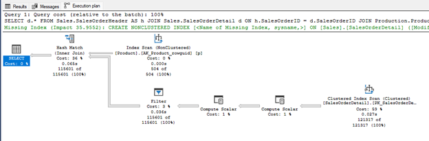

There is no foreign key relationship between the Sales.SalesOrderDetail table and the Production.Product table. Because of this the joining of these two tables is required, even though no information from the Production.Product table is required in the query. If I add a foreign key and re-run the query, we can see that the physical join between the two tables is eliminated:
ALTER TABLE Sales.SalesOrderDetail WITH CHECK
ADD CONSTRAINT fk_SOD_Prod FOREIGN KEY (ProductID) REFERENCES Production.Product (ProductID);
GO
SELECT d.*
FROM Sales.SalesOrderHeader AS h
JOIN Sales.SalesOrderDetail d
ON h.SalesOrderID = d.SalesOrderID
JOIN Production.Product p
ON d.ProductID = p.ProductID
WHERE d.ModifiedDate >= '01/01/2022';

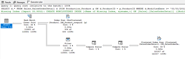

Consider again a variation of the query we’ve been using in this article. The join between the Sales.SalesOrderDetail table and the Production.Product table produces a ‘Hash Match’ physical join:
SELECT d.*
FROM Sales.SalesOrderDetail d
A HASH JOIN is generally great for dealing with large amounts of data. It first builds a data structure in memory, hashing the keys involved in the join operation. This is known as the “Build” phase, and it is a blocking phase (blocking in the sense of pausing the query, not blocking other operations via locks) because it will often need to request additional workspace memory. Ideally this “outer” table is the smaller of the two tables. Then the rows for the other input are scanned, hashed, and compared to values in the build phase. This is a great choice for joining two large inputs.

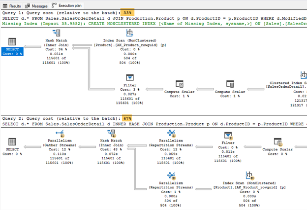

It may be tempting to use a hint to ensure that a HASH JOIN is always used. However, this can cause some unforeseen issues if done without testing. The reason for this is when a physical join hint is used in a query, the ordering of how the tables is written in the statement is enforced. Simply adding the keyword HASH to the INNER JOIN statement will always cause the HASH JOIN to occur, as shown below:
SELECT d.*
INNER HASH JOIN Production.Product p
In this case, however, the larger of the two tables, Sales.SalesOrderDetail, is the build input, causing the overall execution of the query to be much slower than the original query without the hint.
Executing the two queries in the same batch, we can see the query without the hint is twice as fast (according to costs in the query plan – and the CPU time of the execution) as the query with the hint and the forced ordering:
