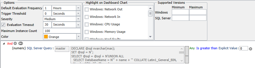

These conditions are SQL Server queries that are set by default to run once every hour (Default Evaluation Frequency = 1 Hour), with a Severity level of Medium.
The SQL Server Query is set to match the Default Evaluation Frequency. When this condition executes, it looks for changes that have taken place within the past hour.
WHERE [p].[modify_date] >= (SELECT DATEADD(HH, -1, GETDATE()))
If you change the Default Evaluation Frequency to 15 minutes, then you would need to change the HH to MI and the -1 to -15, as shown in the following example:
WHERE [p].[modify_date] >= (SELECT DATEADD(MI, -15, GETDATE()))
See the Microsoft Docs article on DATEADD for details and examples.
The query is also set to ignore system databases (database_id > 4) and databases that aren't online (state = 0).
WHERE database_id > 4 AND state = 0;
You might be interested in including system databases or even making a separate condition that is for system databases only. I think you'll want to exclude tempdb in most cases, though, especially for the Tables - Created condition.
See the Microsoft Docs article on sys.databases for more information about the database_id and state columns.

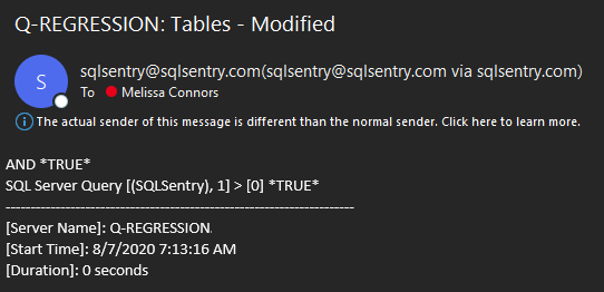

Action: Send Email
If you've set up an email action, you would see something like the following, where the name of the target is in the subject, followed by the name of the condition, and the body starts with:
AND *TRUE*
SQL Server Query [(SQLSentry), 1] > [0] *TRUE*
SQLSentry is the name of the database and 1 is the number of tables modified.
At this point, you can manually run the query in the description of the associated condition to get a detailed list of results from each of the databases listed. For example, the Stored Procedures - Modified condition contains the following query in the description:

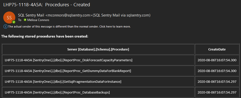

Action: Execute SQL
Would you rather receive an email that lists the server, database, schema, object name, and create/modify date instead? Adding an Execute SQL action to the condition allows you to receive an email similar to the one shown below:
I'm going to walk through the basics that pertain to these conditions. Please see the "Customizing Your Alert Emails in SQL Sentry" blog post from Lori Edwards for a complete walk-through of how to use the Execute SQL action to generate and format an email like the one in this example.
