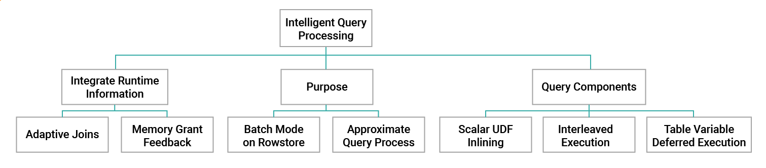

Figure 1 shows the main IQP features and where they’re applied during query planning. The rest of this article describes the purpose of each feature and how it does its job.
Figure 1: The three main features of Intelligent Query Processing

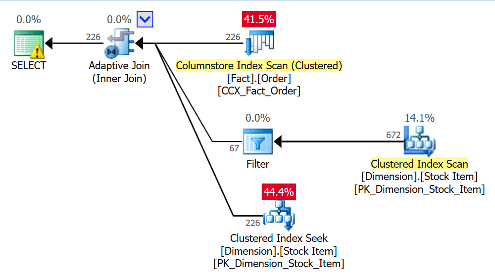

Adaptive Joins is an example of an IQP tool that modifies your plan based on runtime feedback. Normally, SQL Server decides what type of join to use at planning time, based on a best guess of how many rows will be joined at run time. With Adaptive Joins, SQL Server makes the decision at run time, based on the actual number of rows involved. If, as it turns out, there are a lot of rows to join in the record sets involved in the join, SQL Server will dynamically choose a hash join. If, on the other hand, 10 or fewer rows are being joined to a larger, indexed record set, SQL Server dynamically chooses a nested loop join.
In Figure 2, a Plan Explorer diagram shows the analysis of a query using an Adaptive Join. Three tables are joined together using an Adaptive Join before delivering the result to the Select clause.
Figure 2: An Overview of Sentry One Plan Explorer Showing an Adaptive Join
