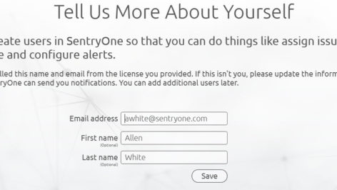

At this point, I switch to the workstation where I'll install the client. I only need to copy the SentryOne install program there and run it. I opt to install every component except the monitoring service, specify WS16SQL2 as the server hosting the SentryOne repository database, and when it's done, indicate that I want to run the S1 client. When it opens, it displays my name and email address (which it got from the license key I've already inserted into the dbo.License table), which I verify.
