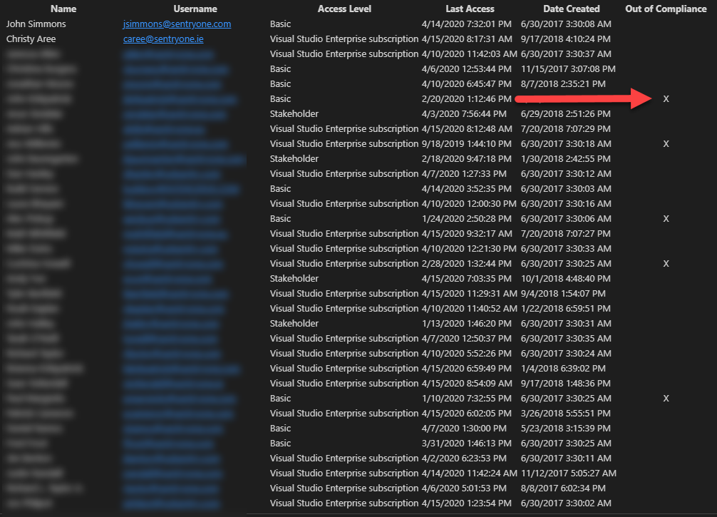

This script creates a markdown file that is similar to the .csv file produced via the Export Users button and includes an additional column for any users that are using paid license types who have not accessed Azure DevOps in the past thirty days.
Below is a preview of what the script will output. I have drawn an arrow to highlight that the license for this user is Out of Compliance, as it's a paid license type and it has been 30 days since this user accessed Azure DevOps.

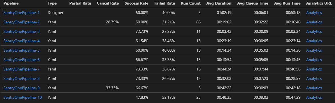

Here is a preview of what the script outputs so that you can get an idea of the stats produced.
I ran this script against one of our smaller projects and manipulated the data a bit to help illustrate the output (and to protect the innocent and guilty). We do not use this naming convention for pipelines, although I might pitch the idea of naming all the pipelines like this in the future!
The output is designed to give you a good starting point to jump in and decide which pipeline might be worth your time to tune. The first pipeline listed, SQL SentryPipeline-1, is a bit of a pig, with an average duration of an hour and decently sized six-minute average queue. It's also still using the designer (i.e., it is a GUI-based build). My first instinct might be to work on converting this definition to YAML and start tuning it, but it only ran five times in the past 14 days. So, I think you could make an argument your time might be better spent elsewhere.
Instead, it is probably a good idea to work on tuning SentryOnePipeline-2, which has run 66 times in the specified time period. It is getting canceled fairly often, and it also fails at 21 percent clip. Seems like this pipeline is getting exercised a good bit and needs some love.

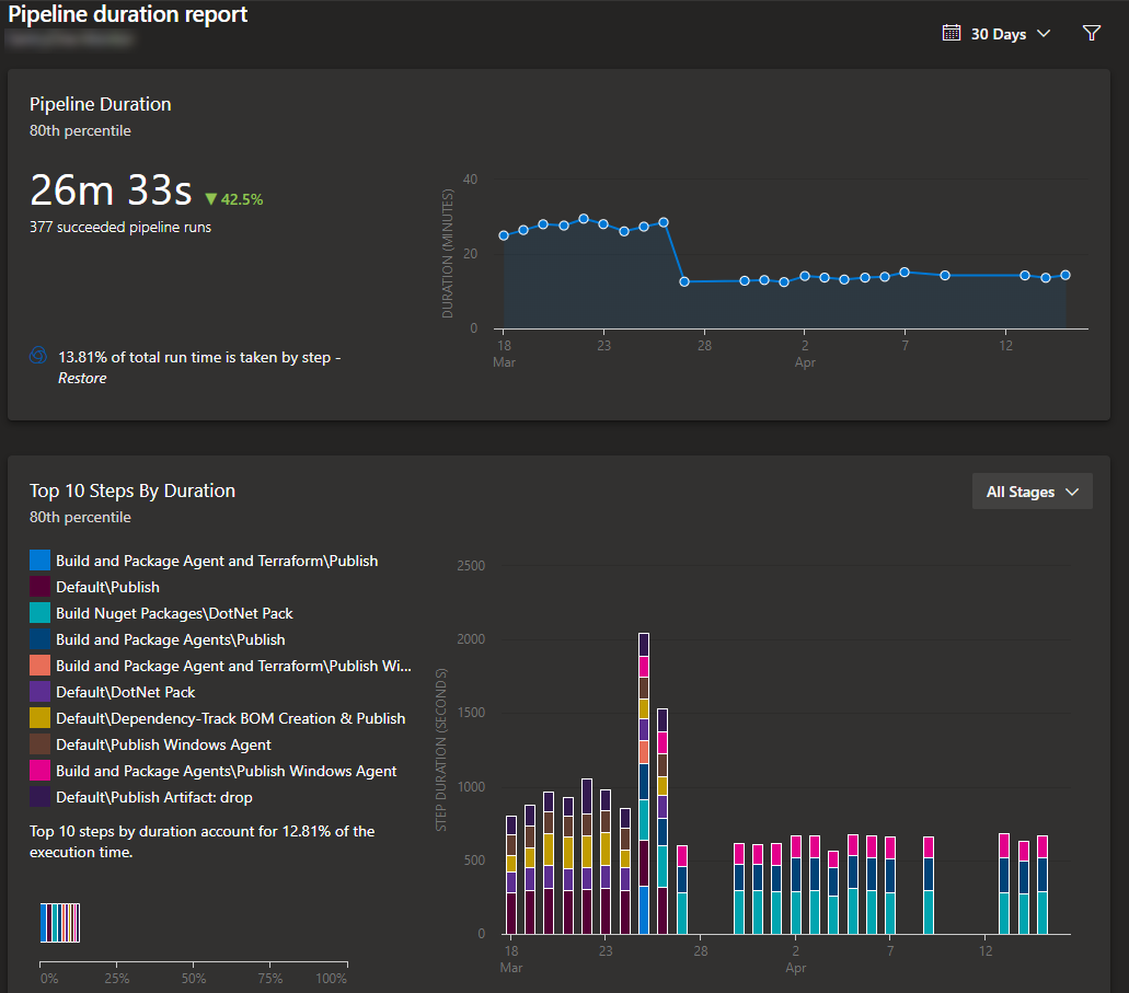

If you click the Analytics link, it will jump you over to the Azure DevOps analytics duration pipeline page. You can use this page to do a deep dive into what is contributing to your pipeline's duration. It has a breakdown of the top 10 steps by duration across the entire pipeline. You can also use the Stage drop-down menu to see a further breakdown of step duration per stage.
Here is a screenshot of one of the pipelines that we tuned recently for SQL Sentry Portal.
This pipeline suffered from some natural bloat as the project picked up steam. We identified it needed attention and set about optimizing it. Following the steps I detailed above, including breaking the workload out into parallel stages, we were able to get about a 40 percent improvement in build time—reducing it from 26 minutes to 14 minutes.
