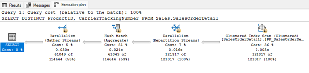

The execution plan below is for the simple query above, and you can see SQL Server chose to use a Hash Match Aggregation.

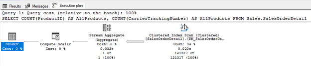

In the following query, I return a list of all ProductID values and CarrierTrackingNumber values from the Sales.SalesOrderDetail table. Notice how the count for the ProductID column is significantly higher than the count of the CarrierTrackingNumber values. This is because the CarrierTrackingNumber column contains NULL values while the ProductID column does not allow NULL values. NULL values aren’t considered in aggregate functions.
SELECT
COUNT (ProductID) AS AllProducts,
COUNT (CarrierTrackingNumber) AS AllCTN
FROM Sales.SalesOrderDetail;

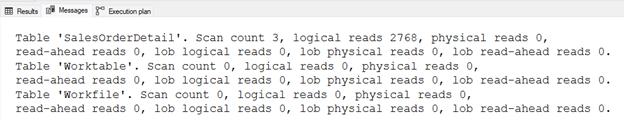

After enabling SET STATISTICS IO ON and getting the execution plan, we can see the query used a clustered index scan and read 1,246 pages:

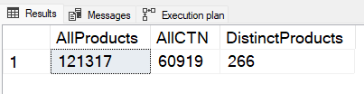

From the returned results, we see there are 266 distinct values in the ProductID column:

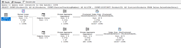

Using DISTINCT inside the COUNT function is a helpful way to determine how unique the distribution of values in a column is. However, like everything else regarding computing, there is a trade-off as this aggregation is not cost-free.
Although all the data in the table is already being scanned, SQL Server still needs to reaccess a data structure to perform the DISTINCT aggregation. In this case, because a non-clustered index exists on the ProductID column, SQL Server can scan that index to return the distinct values for the column. Below we see the extra scan of the non-clustered index in the execution plan:
We also see the extra pages read from the buffer pool for the second index scan:

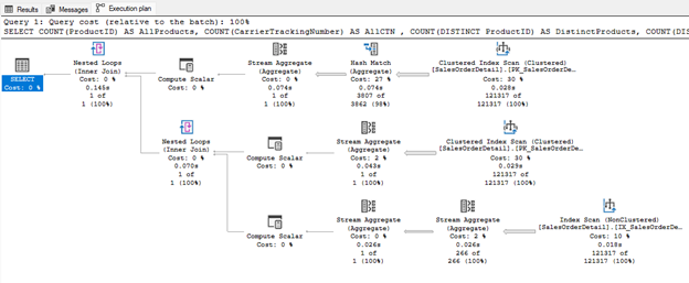

So, what happens if I include a COUNT DISTINCT operation on a column without an existing non-clustered index? In this case, an extra table scan must occur to perform the DISTINCT aggregation. Below I include a COUNT DISTINCT on the CarrierTrackingNumber column, and the column returns 3,806 distinct values:
SELECT
COUNT (CarrierTrackingNumber) AS AllCTN ,
COUNT (DISTINCT ProductID) AS DistinctProducts,
COUNT (DISTINCT CarrierTrackingNumber) AS DistinctCTN
And the resulting execution plan includes an extra clustered index scan:
This is a crucial point to take away. Just because your query only references a single table doesn’t mean your query will, at maximum, read all of the data in the table a single time.

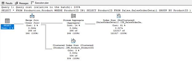

If I alter the query a bit to include a GROUP BY instead of the simple inner query above, we can see the resulting execution plan is the same:
SELECT
FROM Production.Product
WHERE ProductID IN
SELECT
ProductID
GROUP BY ProductID

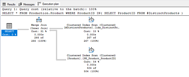

So, what happens if the inner query returns a list of already unique values? In such a case, SQL Server is smart enough not to perform an aggregation to return a DISTINCT list.
To show this, let’s get a unique list of ProductID values from the SalesOrderDetail table and put them in a temp table. Notice how I include a NULL value in this table (more on why I’m doing this in a moment):
SELECT DISTINCT
ProductID
INTO #DistinctProducts
UNION ALL
SELECT
NULL;
Next, I’ll create a UNIQUE clustered index on the table. This will guarantee no duplicate values can exist in the table. Also, UNIQUE indexes allow for a single NULL value in SQL Server:
CREATE UNIQUE CLUSTERED INDEX
idx_DistinctProducts
ON #DistinctProducts (ProductID);
Now, when I execute the query and use the temp table containing unique values, we can see from the execution plan how the aggregation to return a DISTINCT list of values is no longer needed.
