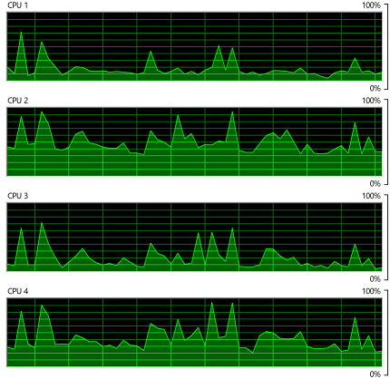

Max degree of parallelism (MAXDOP)is a setting in SQL Server that controls how many processors may be used for parallel plan execution. Parallel plan execution is good—it lets SQL Server make the best use of all those processors in modern servers. However, MAXDOP can be configured incorrectly. Too much or too little parallelism can negatively impact server performance.
Windows CPU Monitor
