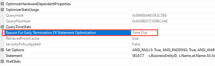

When I execute the query and look at the execution plan, I see the plan has a ‘Reason For Early Termination of Statement Optimization’ value of ‘Time Out.’
This means during the query optimization phase, there were so many plan options the time limit for optimization was hit, and the “best” plan of the explored plan alternatives was chosen as the execution plan. This happens quite often. If you have complex T-SQL statements and aren’t getting the execution plan you’d like, it may be time to refactor those T-SQL statements, so they involve fewer joins or break them into separate statements.

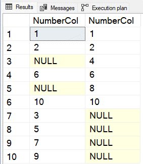

FULL OUTER JOIN
A T-SQL FULL OUTER JOIN combines the functionality of the LEFT and RIGHT OUTER JOINs. Use this type of JOIN when you want to return (preserve) rows from both tables. When there is no match between the two tables, NULL values are returned. The following query returns rows from the #Numbers1 and #Numbers2 table:
SELECT
n1.NumberCol,
n2.NumberCol
FROM #Numbers2 n2
FULL OUTER JOIN #Numbers1 n1
ON n2.NumberCol = n1.NumberCol;
When there’s a match between the tables, both values will be returned. When there’s not a match, the value from the table where the value exists is returned, and a NULL value is returned from the other table.
