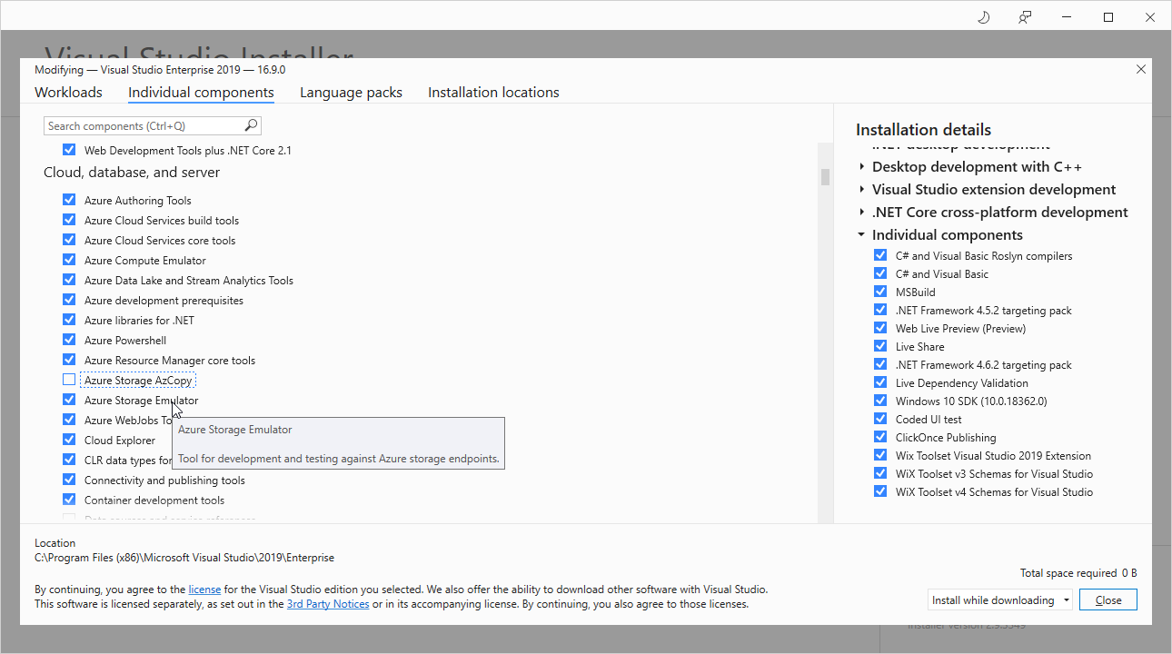

There are two ways to get the Azure Storage Emulator:
- You can install it via the Visual Studio installer. It’s included in the Azure Development workload or can be individually selected under the Cloud, database, and server section.
- You can download a standalone installer from the official Microsoft documentation here.

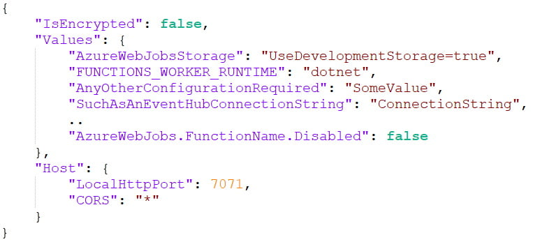

To connect the Function to the Emulator, replace the AzureWebJobsStorage connection string with “UseDevelopmentStorage=true” (see next section for where to configure this). The Emulator will automatically start when the project is run in Visual Studio, and no further steps should be needed to connect to it.

To provide the configuration values typically found in the Azure Function’s App Service configuration, a local.settings.json file is used. The file is typically added at the project root directory, and, if added to the solution in Visual Studio, is set to Build Action: None and Copy to Output Directory: Copy Always or Copy If Newer. This file isn’t typically checked into source control because of the amount of infrastructure access information it contains, so it’s recommended you add it to a .gitignore file (or equivalent if using an alternative to Git).
The full specification for the local.settings.json file can be found in the Microsoft documentation, but a sample file might look like the following:
All the settings required for the Azure Function should be included in this file under the Values section. Typically, these values would match those found in the App Service configuration but changing the values here would allow for a separate development environment if desired.
A few specific settings in this file warrant a mention.
- The “AzureWebJobs.FunctionName.Disabled” values are unique to the settings.json file and won’t appear in Azure. These values will be discussed in more detail in the next section.
- The “LocalHttpPort” value is ignored when running via Visual Studio, which will set a port as a command line argument automatically. You can set this value by going to the project’s properties and including the following line in the Application Arguments section:
host start --pause-on-error --port ####
- The “AzureWebJobsStorage” line was discussed in the previous section as a way to connect to the Azure Storage Emulator.

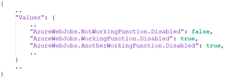

In the previous section, I discussed using the configuration values “AzureWebJobs.FunctionName.Disabled” to run only certain Azure Functions at a time. The pattern I’ve used for developing related Functions is to put multiple within the same project, which is then deployed as a single DLL to Azure. However, when you run the Functions locally, by default it runs all Functions. This can pose a problem when only one Function needs debugging and you’d prefer the Azure infrastructure run the rest of the Functions while you work on the problematic Function.
The “AzureWebJobs.FunctionName.Disabled” values need to be added for each Function you want to prevent from running locally; there’s no logical inverse of only running a specified Function. An example local.settings.json file with these values might look like the following:
I like to add a new line for every Function in the project, with a default value of true, to the local.settings.json file as soon as I create the Function. This helps prevent accidentally running a Function that’s already running in Azure.
But what happens when you run a Function locally that’s also still running in Azure? Requests to the Function can get routed to either running instance of the Function indeterminately, which can become an issue if you’re testing changes and have two different versions running.
