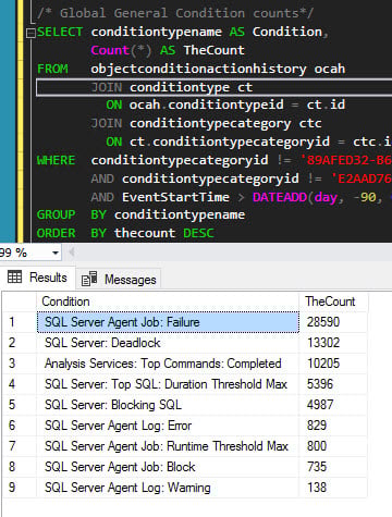

First, look at which alerts are triggering most frequently across your monitored environment. You’ll find the main culprit of alerting noise is often job failures.
Example result set for the noisiest alerts

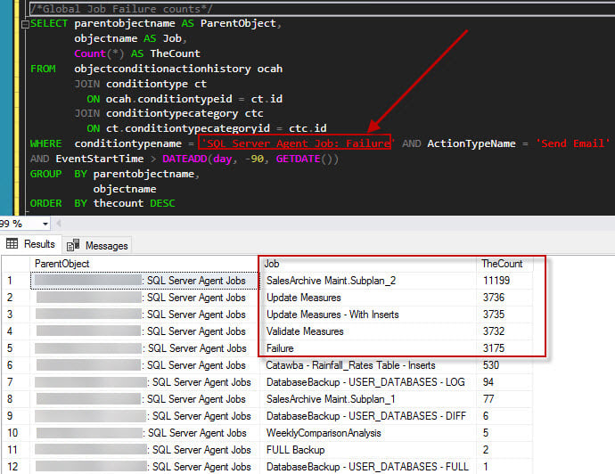

Next, dig deeper into which jobs are generating the alerting noise. In this example, we quickly see a subset of jobs generating the majority of the failure alerts. At this point, you’ll want to reflect on these jobs by asking yourself the following questions:
- What are they?
- What do they do?
- What does the failure volume indicate? Are these jobs expected to fail often, or could this indicate a resolvable issue with the jobs rather than a need to tune alerting for them?
- Is there value in being alerted to the job failures? If so, do you need to be alerted to every single occurrence?
Example result set of jobs causing the most failure alerts

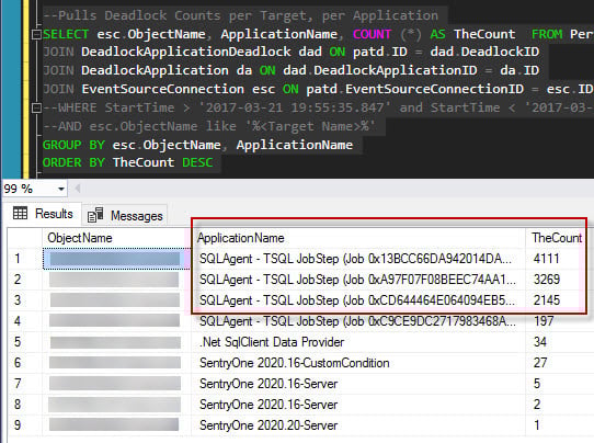

Now, let’s look at the second highest count alert: deadlocks. At the bottom of the alert mining script attached at the end of the blog post, there are queries capable of pulling deadlock counts by application, database, user, resource, or text data. For simplicity, we’ll just look by application in this example.
You’ll want to reflect on these alerts by asking yourself the following questions:
- Is there value in getting alerts for a particular deadlock?
- Are the deadlocks tied to a third-party application you have little to no control over or another process with low criticality? If so, does it make sense to be alerted on it?
- Do you need to be alerted to every occurrence of a particular deadlock, or only if it snowballs? (For example, you could receive alerts only when there have been X number of deadlocks within Y amount of time.)
Example result set of applications causing the most deadlocks
