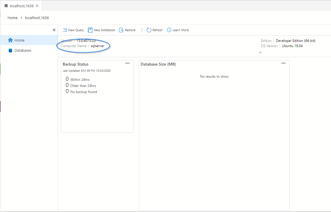

Now that the hostname is configured, let's verify that it is working using Azure Data Studio.
We can see on the Home view that the Computer Name has been updated to sqlserver. Now it’s time for the tricky part of this setup—mapping the hostname that you used to the server that is running your container.

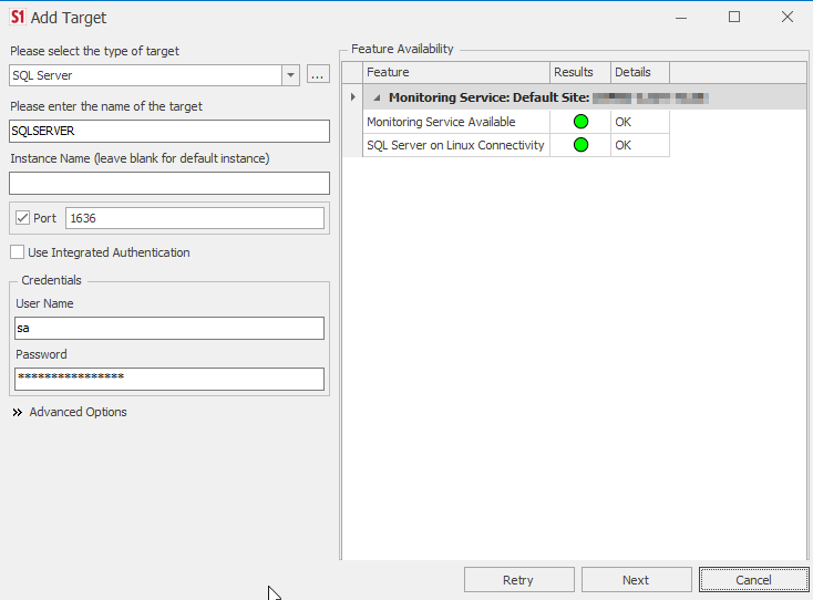

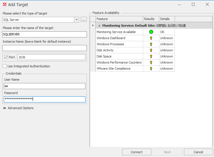

Open the SQL Sentry client and add a target. Enter the hostname, port, and switch to SQL authentication. Enter the sa account’s password set during the run command in the Credentials section. After a few seconds, you should see it connecting to a SQL Server on Linux target, and the target then shows up in the client.
The following screenshot shows the Add Target dialog box.

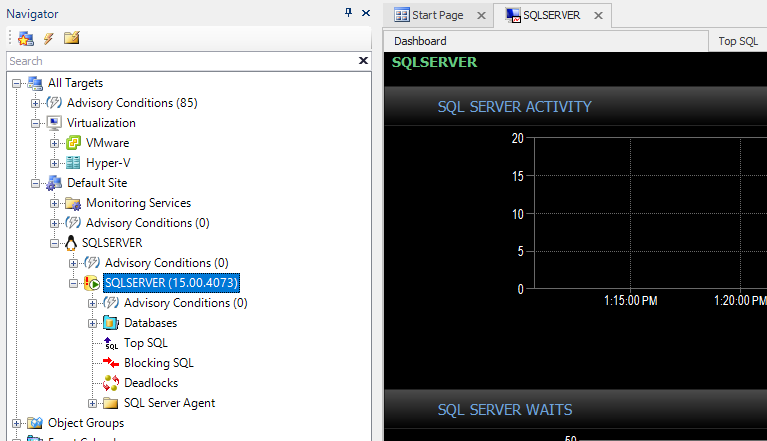

Here is what it looks like after the target has been added and detects that it is on Linux:
And finally, here it is in the SQL Sentry client:
