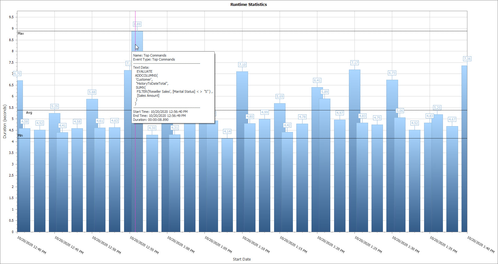

From the Top Commands tab for my SSAS instance in SQL Sentry, I can right click the query in question and select Jump To > Runtime Stats. Doing so displays a runtime history chart like the one shown below. From there, I can see the recent history of the selected query and easily spot any trends in the query’s runtime.
In the above example, I can see one particular outlier. This query seems to average about 5.5 seconds but took almost 9 seconds for the selected execution.

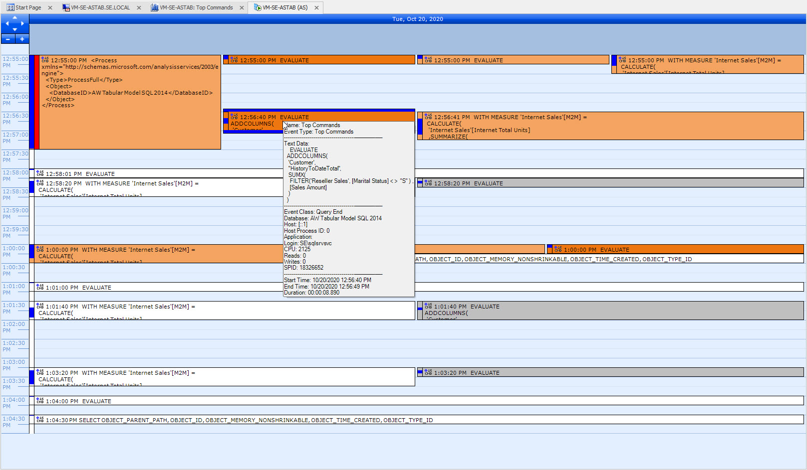

Another right-click and I can Jump To > This Instance in the Event Calendar view and easily see what else was running on the server at the same time. I am just looking at events for this SSAS instance, but I could include events from other instances (e.g., SQL Server, SSAS, SSIS) that might be sharing the same resources or running on other servers. This can be especially useful for eliminating issues if physical resources are over-provisioned.
In this case, I can see the query was running concurrently, not just with another query, but while a failed attempt at processing was occurring, too. The fact that these ran concurrently could easily explain why the query ran longer than normal and, possibly, why the processing command failed. Note I can highlight events in orange on the calendar automatically based on concurrency with other events in the view.
In this case, I might just write off the issue as a random occurrence, or I might want to look into the scheduling of my processing activity or other events to eliminate conflicts. When investigating a long-running SSAS query, determining when processing last occurred is extremely important, not only because of resource bottlenecks but also because caches might be cleared or more data added that could significantly impact the query runtime.

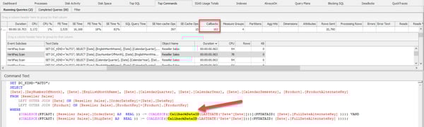

One easy issue to spot in the SE is callbacks. Generally speaking, pushing simple calculations to the SE in Tabular SSAS is a good thing since it’s optimized in memory. That said, some calculations cannot be pushed to the SE and might require a callback to the FE on a row-by-row basis.
These are commonly seen with IF and LASTDATE functions. This will cause the SE to send a callback to the FE. If you are seeing callbacks involved with one of your longest VertiPaq scans for your query, look for options to change the order of operations to eliminate them in the query plan.
You can spot callbacks in the Top Commands tab of SQL Sentry at the query level in the Callbacks column, which will provide a count for the entire DAX or MDX statement. We will also highlight them in the Command Text of the individual VertiPaq scans where they occur.
