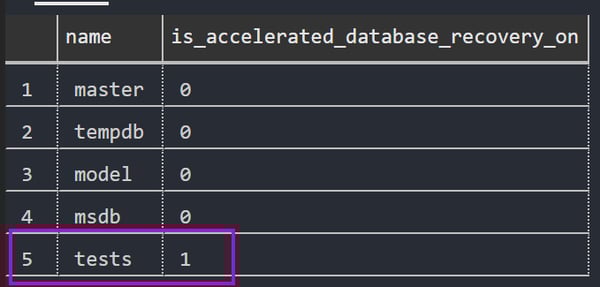

We can check to see that it took with a new column in sys.databases:

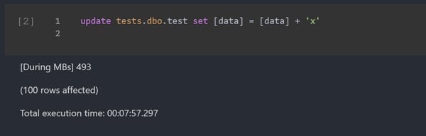

After enabling ADR on the database and making sure it's working, I get the following output from running an update:
Using this bit in the trigger:
SELECT @SPID and database_id = 2
I'm informed that we've put roughly 493MB into tempdb. That tells me that the trigger is indeed still using the tempdb version store.

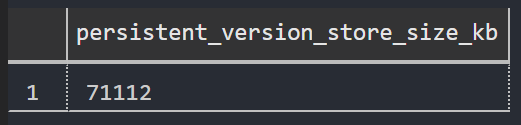

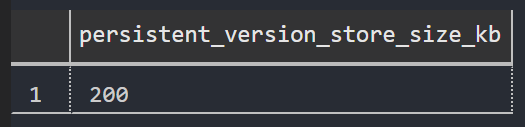

I wondered if the PVS was also active during this update, so I checked that, too. I did all this relatively in sequence and with nothing else going on with this database. The PVS was previously 200KB, and I felt that it should be much larger now:
It is bigger indeed. I've added about 70MB in version data.

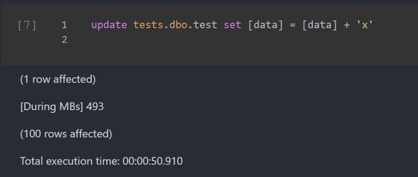

Next, I ran the big update again with the following results:

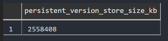

The trigger tables still went to tempdb, but the PVS grew a lot:

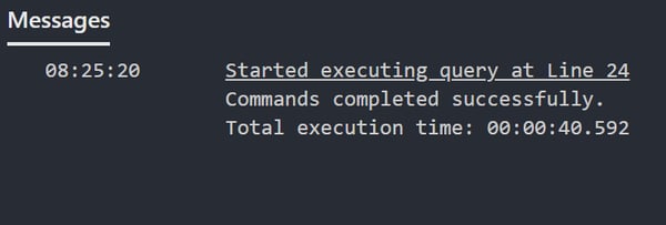

That procedure runs a background cleanup process. It didn't seem to create any sort of blocking, but I was surprised by how long it took:
I've built out background processes like this before, and they tend to take longer on purpose due to patterns that keep them from impacting performance. Given that, I wasn't worried at all about how long it took, I just wasn't expecting it.

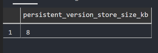

After another wait for everything to cycle through, I could see the PVS was down to 8KB:
