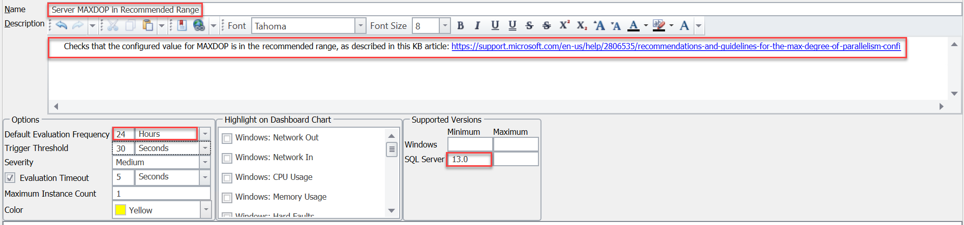

When creating the Advisory Condition, choose the SQL Server type.
For the properties, use the following list:
*You can set this to run more frequently, but it’s not necessary in most environments.
When these settings are made, your Advisory Condition should look like this one:
