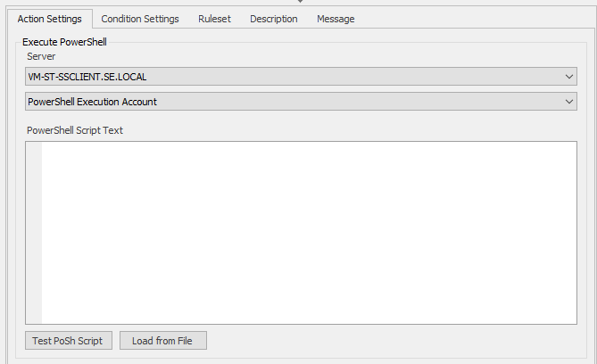

Execute PowerShell
Executing a PowerShell script as a remediation step is extremely powerful. It opens up all kinds of possibilities to integrate with other systems or fix potential issues. There's a great post on how to use the PowerShell Action. If PowerShell floats your boat, then prepare yourself for the voyage of a lifetime.
