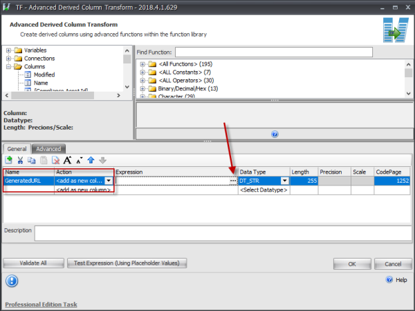

Add, connect, and open an Advanced Derived Column after closing the SharePoint Source. Then, add a new column, name it, and click the Expression ellipsis (shown in the screenshot below) to open the Expression Editor.
The Expression ellipsis to open the Expression Editor

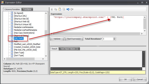

Return to the Advanced Derived Column’s Expression Editor. In the Expression window, paste the URL copied from the web browser and surround it with single quotation marks. Also, append + [URL Path] to the end of the expression, as shown in the screenshot below. Note that you can find the URL Path column in the Columns/Variables list located in the left pane. You can drag and drop the URL Path column into the Expression window or type it in. If you are unable to locate URL Path in the Columns/Variables list, please return to the SharePoint Source and ensure the Include Hidden Columns option is selected.
Appending the URL path to the end of the expression

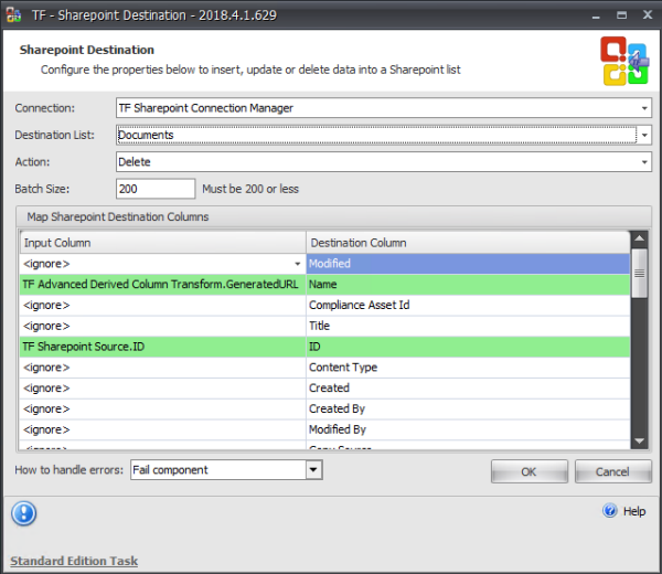

You now have all the necessary data needed to configure the SharePoint Destination to perform a delete action. Add a SharePoint Destination to the data flow, connect it to the Advanced Derived Column, and open the SharePoint Destination. Next, select/create a connection manager, point to the documents list, and set the Action to Delete. Finally, map the ID and Name columns. In the example shown below, we have mapped the SharePoint Source’s ID column to the ID destination column and the GeneratedURL column created in the Advanced Derived Column to the destination’s Name column. All other mapped columns should be removed by selecting Ignore from the drop-down menu. Click OK to close the SharePoint Destination.
Mapping the ID and Name columns
