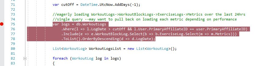

I'm going to need to get the exact query that gathers data for this feature and the way to do that is to stop on a breakpoint in the application code.

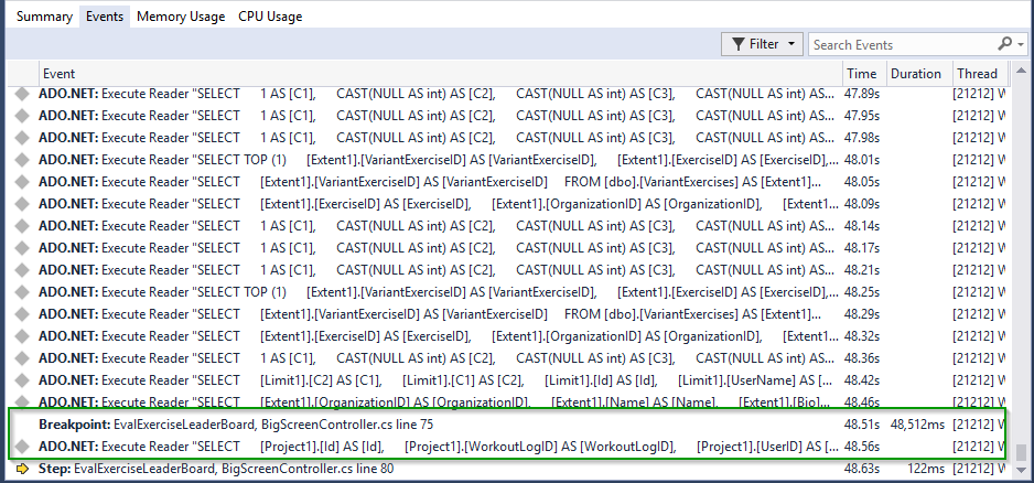

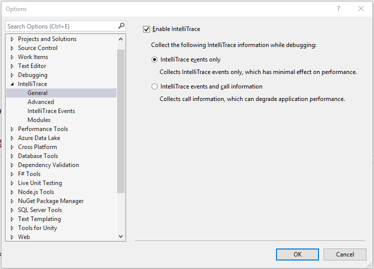

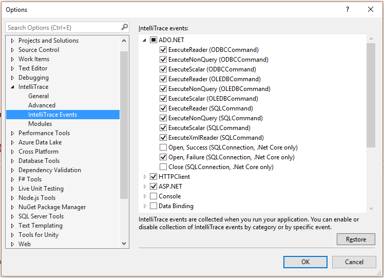

That isn't all, though. I also want to use a Visual Studio feature called Intellitrace. I had it turned off (because it slows down debugging) but in this case I really need it because it can show me the query that's being sent from Entity Framework to the Azure SQL Database.
Now, when I debug and navigate to the Big Screen, I'll hit my breakpoint, step over it, and grab my query from the Intellitrace profiler. It will be the next ADO event after the breakpoint.
From here, I take the query, open Plan Explorer, and get to work. I'm hoping to avoid rewriting the query, so I'm going to look at things like statistics, and indexing opportunities first.

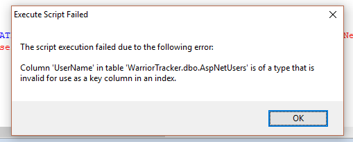

One thing I know (because I know the application, and the code, very well) is that this query runs all the time, on every page, and in just about every function. If one thing has to run blazingly fast, it's this query. With that in mind, when I go to my Index Analysis tab in PE, the first thing I see is a bit upsetting:
The index being used by this query is not very efficient at all. Part of it, indeed, is how Entity Framework put the T-SQL together. It is quite hard to follow, and overly aggressive considering the data that I actually need at this point. However I am not going to focus on that. Instead, I'm going to focus on making an index that the query can use to run better.
I am filtering on both Username, and Id for the user table. I think something using those 2 columns could help me out. However, as I begin to formulate a plan, I am stopped by what I am going to call poor database design. I don't mind saying that, because the truth is, I am the one that did it. Early on, it was assumed we would always be searching for users by their Id, and the Username column was created using nvarchar(max). It was decided that the application would control the length of the Username, and it does, but this is an example of how we should be thinking about database performance at every stage of a project, no matter how big or small. You see, I can't use this column in an index key, because of the data type, and to change the data type now is going to introduce a lot of risk. I still have options, but the easiest is all but closed to me, with noone to blame but myself.
With that weighing heavily on my options, I decide the best way forward, for now, will be to reduce how often this query runs dramatically. I can look the user data up this way once, without the additional join. Then I can hold the Id in cache, and use that to grab the full user context from that point on. This will always use the clustered index on the user table, and reduce the overall cost of this query running all the time by turning the scan into a seek for a single row from a clustered index.
And, that is what I did, ultimately resulting in a consistent reduction in DTU usage on the Azure SQL Database. I will look to refactor the table later, but for now I have the desired effect.
