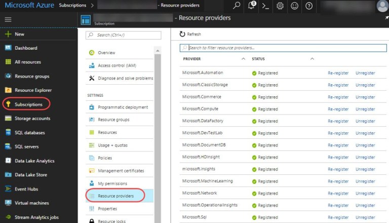

Resource Provider: A resource provider is specified within the ARM template. The most common resource providers are pre-registered, but you may need to register some before deploying a resource. Resource providers registered for use with your subscription can be found in the portal (or via PowerShell, REST API, or CLI).
The resource provider allows access to resource types, and in turn allows communication between each resource and Azure Resource Manager:

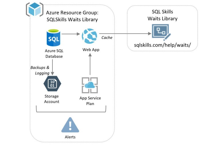

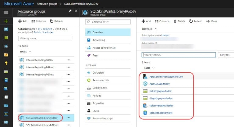

For this post, I’m going to use the Azure infrastructure behind the visuals shown in the SQLSkills Waits Library as an example for how to do an ARM deployment:
For the purposes of this post, each of the resource names and parameter values have been changed somewhat from the real names. Also, the source data and data integration processes for getting the data into the Azure SQLDB are omitted for brevity so that we focus only on the ARM components. (For those interested, the source data for the charts comes from our SentryOne customers who have opted to sync data to cloud.sentryone.com. This data is first anonymized, then extracted into an internal data warehouse, and finally summarized to refresh aggregates in Azure SQLDB when a calendar month completes.)
In our Azure environment for the Analytics team, we have separate Development and Production resource groups for this set of resources to support the SQLSkills Waits Library visuals (we’ll introduce a 3rd tier for UAT/Stage purposes later if necessary but we have not fired up a 3rd set of resources until it becomes necessary). Other than naming and scale level (i.e., cost), the Production and Dev resources are exact copies of each other -- unless of course active development is occurring which hasn’t yet been migrated to Prod.

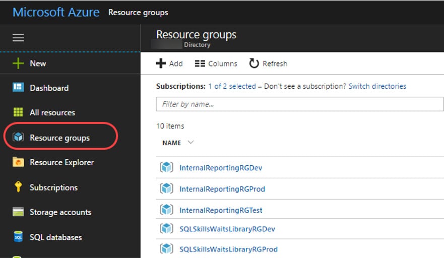

Importance of Resource Groups
Resource groups are extremely useful as a ‘container’ for organizing and separating resources. However, resource groups are more than just a logical container though - they are extremely fundamental to ARM. Whenever you generate an ARM automation script from the Azure portal, you always get the code for the entire resource group even if you’re in the scope of a single resource. For that reason, it is important to keep resource groups more narrow than broad. From an ARM perspective, all assets in a resource group are intended to be deployed, managed, and secured as a group. (You can see the ARM script for individual resources in the Resource Explorer-it also exposes Resource Providers nicely.)
Another advantage of resource groups is you can assign permissions (RBAC – role-based access control) at the resource group level, so security will be inherited by all resources within that resource group. For instance, perhaps you want to allow a certain user, group, or service principal to be an owner, contributor, or reader of all resources within the confines of one resource group. The inheritance model is: Subscription > Resource Group > Resource (therefore, it’s often best to set roles at the subscription level only if they should inherit across all, or at least most, resource groups).
One more advantage is that you can also set policies to apply across a resource group. For instance, you can specify things such as allowed resources (or not allowed resource types), allowed locations, allowed storage SKUs, or a requirement for storage account encryption.

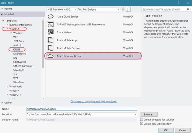

Creating an ARM Project in Visual Studio
In Visual Studio, there is an “Azure Resource Group” type of project under Visual C# > Cloud:
If you don’t see this option, that means the Azure SDK hasn’t been installed yet. For more information, see this post.
Note: all screen shots shown here are from Visual Studio 2015 (because, at the time of this writing, not all extensions for BI and Azure projects are available yet in VS 2017).
Make sure you don’t use any special characters in your Visual Studio project name if you intend to deploy directly from Visual Studio (discussed later in this post). It uses the project name as the deployment name and you will get the following error:

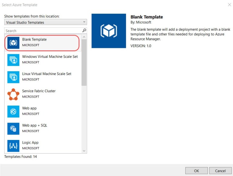

Before it creates the project, you are prompted to choose an Azure Template. If you want to choose a template to poke around what it looks like, that’s a good way to learn syntax. Based on my workflow, I usually choose a blank template now.
Once the project is created, you will see 3 files:
The names of the files will differ, based on if you selected a template or not. If this structure works for you, that’s great. However, I have come up with a slightly different structure to use instead.

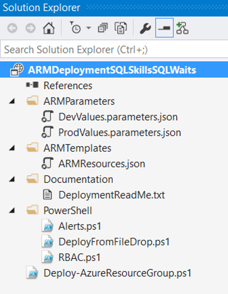

Visual Studio ARM Project Structure
The structure I’m working with looks like this:
ARMParameters folder: Contains one JSON parameters file for each environment that I need to deploy this solution to. For this solution, we only require 2 environments so far instead of 3 or 4.
ARMTemplates folder: Contains the main JSON file for deployment (I call it ARMResources.json – the original structure created by Visual Studio calls it azuredeploy.json).
Documentation folder: Just a simple document with any pertinent notes or instructions. Helpful for colleagues that might need do a deployment, but didn’t design it from the ground up. Or to specify if there’s a particular property that needs to be set after deployment which isn’t exposed via ARM.
PowerShell folder: These are scripts which are separate from the ARM template. Alerts could be part of the ARM template if you want, but they get verbose so I like to separate them out in PowerShell instead. I'm also separating Role-Based Access Control (RBAC) specifications so they don't get 'buried' in the main ARM template. The DeployFromFileDrop.ps1 is discussed later in this post (it picks up the JSON files from a drop zone and does the deployment to Azure).
Deploy-AzureResourceGroup.ps1 file: This is a deployment file required by Visual Studio if you choose to deploy from VS (right-click the project name and choose deploy). I’ve only gotten myself in trouble when I try to edit this file, so now I just leave it alone. Do make sure the Build Action on this file is set to Content (if it’s set to None, you’ll get an error: "PowerShell deployment script is missing in project").

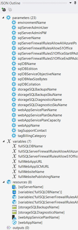

You’ll want to use the +/- buttons to collapse the sections in the main window after the script gets verbose enough.
There is also the JSON Outline pane which helps you jump to a specific item in the JSON script:

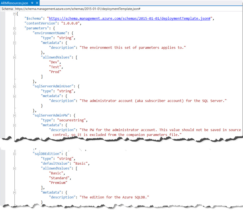

Let’s break down each of the sections in the ARM template file:
1. $schema
This refers to the JSON schema. Note that the schema specified is different in the parameters file vs. the main ARM deployment file.
2. contentVersion
You can increment this version if you’d like to manage the changes made over time. The default is “1.0.0.0.”
3. Parameters
Next are the parameter definitions (not the values, just the definitions for each parameter).
Type: Most commonly string or int; note the sqlServerAdminPW is set to be a securestring. By setting it to securestring, it won’t be a visible value in the deployment status log.
Metadata Description: Helpful info to remember what it’s used for, or any other notes you want to leave for yourself and your team.
Allowed Values: If there are only certain options which will work successfuly (such as the sqlDB Edition shown above), this is really helpful.
Default Value: Makes sense in certain circumstances. If there’s not a default value, then the value needs to be in the separate parameters file, or typed in at deployment time.

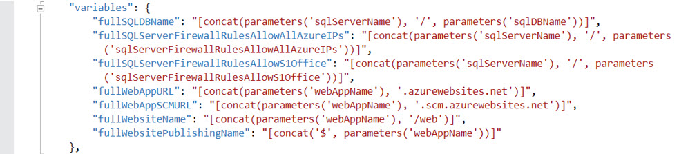

4. Variables
Next is the variables section:
The variables section can be optionally used for things that do vary but can be worked out systematically via JSON fragments. The idea here is to simplify what’s in the resources section. Note that variables do not have definitions (allowed values, default values, etc) the way parameters do.
If you prefer, you can input values directly into the variables section instead of the parameters file. A lot of examples online do this, and some ARM template authors purposely try to minimize the number of parameters. I like to centralize all of my inputs into the parameters file, rather than have some values in parameters and some values some in variables. However, it’s really up to you – both parameters and variables feed values to the resources.

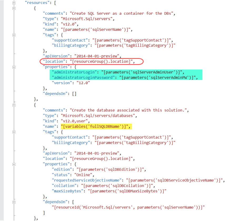

5. Resources
The resources section is where everything comes together:
The resources section defines each resource to be deployed, with references to parameters and variables as necessary. The elements which are defined vary based on the kind of resource which is being deployed.
Location: You might be tempted to create a parameter for Location. However, a better practice is to inherit the location from the resource group as shown in the above example.
Type: The Type element for a resource is a combination of Resource Provider (discussed above) plus the Resource Type (ex: Microsoft.sql/servers).
Comments: Helpful info to clarify what the resource is, or what it’s being used for.
DependsOn: This helps Azure understand dependencies, so it can deploy resources in parallel, or sequentially, as appropriate.
API Version: A version is specified for each resource which is associated with a version of the REST API. The version impacts which elements can be specified for the resource, so the versions are updated on occasion.
Example syntax from ARMResources.json:
{"$schema": "https://schema.management.azure.com/schemas/2015-01-01/deploymentTemplate.json#","contentVersion": "1.0.0.0","parameters": {"environmentName": {"type": "string","metadata": {"description": "The environment this set of parameters applies to."},"allowedValues": ["Dev","Test","Prod"]},"sqlServerAdminUser": {"type": "string","metadata": {"description": "The administrator account (aka subscriber account) for the SQL Server."}},"sqlServerAdminPW": {"type": "securestring","metadata": {"description": "The PW for the administrator account. This value should not be saved in source control, so it is excluded from the companion parameters file."}},"sqlServerName": {"type": "string","metadata": {"description": "Name – at the server level. Must include the dev/test/prod suffix per naming conventions."}},"sqlServerFirewallRulesAllowAllAzureIPs": {"type": "string","metadata": {"description": "Specifies if firewall is open internally to Azure. See related variable for actual value passed in. Note this applies at the server level, not the database level."}},"sqlServerFirewallRulesAllowS1Office": {"type": "string","metadata": {"description": "Firewall openings for SentryOne office."}},"sqlServerFirewallRulesS1OfficeStartIPAddr": {"type": "string","metadata": {"description": "Start of IP address range for firewall openings for SentryOne office."}},"sqlServerFirewallRulesS1OfficeEndIPAddr": {"type": "string","metadata": {"description": "End of IP address range for firewall openings for SentryOne office."}},"sqlDBName": {"type": "string","metadata": {"description": "The name of the Azure SQLDB. There is no dev/test/prod suffix-this SQLDB name must remain consistent across environments. See related variable for actual value passed in."}},"sqlDBEdition": {"type": "string","defaultValue": "Basic","allowedValues": ["Basic","Standard","Premium"],"metadata": {"description": "The edition for the Azure SQLDB."}},"sqlDBServiceObjectiveName": {"type": "string","defaultValue": "Basic","allowedValues": ["Basic","S0","S1","S2","P1","P2","P3"],"metadata": {"description": "The performance level for the edition of Azure SQLDB. This is expected to be S0 in Dev, and S2 in Prod."}},"sqlDBMaxSizeBytes": {"type": "string","defaultValue": "524288000"},"sqlDBCollation": {"type": "string","defaultValue": "SQL_Latin1_General_CP1_CI_AS","metadata": {"description": "Collation which applies to all DBs in this server."}},"storageSQLBackupsName": {"type": "string","metadata": {"description": "The name of the storage account where automated SQL backups are sent."}},"storageSQLBackupsSkuName": {"type": "string","defaultValue": "Standard_LRS","allowedValues": ["Standard_LRS","Standard_GRS","Standard_ZRS","Premium_LRS"],"metadata": {"description": "The storage account type for automated SQL backups. For backups, we should use GRS."}},"storageSQLDiagnosticsName": {"type": "string","metadata": {"description": "The name of the storage account where automated SQL auditing & logging are sent."}},"storageSQLDiagnosticsSkuName": {"type": "string","defaultValue": "Standard_LRS","allowedValues": ["Standard_LRS","Standard_GRS","Standard_ZRS","Premium_LRS"],"metadata": {"description": "The storage account type for automated SQL backups. For diagnostics, we should use LRS."}},"webAppServicePlanName": {"type": "string","metadata": {"description": "Name for the app service plan (aka hosting plan name)."}},"webAppServicePlanSkuName": {"type": "string","allowedValues": ["F1","D1","B1","B2","B3","S1","S2","S3","P1","P2","P3","P4"],"metadata": {"description": "Pricing tier for the app service plan. Should be Free (F1) in Dev, and Standard (S1) in Prod."}},"webAppServicePlanCapacity": {"type": "int","defaultValue": 1,"minValue": 1,"metadata": {"description": "Instance count for the app service plan."}},"webAppName": {"type": "string","metadata": {"description": "Name for the web app within the App Service Plan."}},"tagSupportContact": {"type": "string","metadata": {"description": "An Azure tag which specifies who to contact for support of these resources."}},"tagBillingCategory": {"type": "string","metadata": {"description": "An Azure tag which specifies the billing category for these resources."}}},"variables": {"fullSQLDBName": "[concat(parameters('sqlServerName'), '/', parameters('sqlDBName'))]","fullSQLServerFirewallRulesAllowAllAzureIPs": "[concat(parameters('sqlServerName'), '/', parameters('sqlServerFirewallRulesAllowAllAzureIPs'))]","fullSQLServerFirewallRulesAllowS1Office": "[concat(parameters('sqlServerName'), '/', parameters('sqlServerFirewallRulesAllowS1Office'))]","fullWebAppURL": "[concat(parameters('webAppName'), '.azurewebsites.net')]","fullWebAppSCMURL": "[concat(parameters('webAppName'), '.scm.azurewebsites.net')]","fullWebsiteName": "[concat(parameters('webAppName'), '/web')]","fullWebsitePublishingName": "[concat('$', parameters('webAppName'))]"},
"resources": [{"comments": "Create SQL Server as a container for the DBs","type": "Microsoft.Sql/servers","kind": "v12.0","name": "[parameters('sqlServerName')]","tags": {"supportContact": "[parameters('tagSupportContact')]","billingCategory": "[parameters('tagBillingCategory')]"},"apiVersion": "2014-04-01-preview","location": "[resourceGroup().location]","properties": {"administratorLogin": "[parameters('sqlServerAdminUser')]","administratorLoginPassword": "[parameters('sqlServerAdminPW')]","version": "12.0"},"dependsOn": []},{"comments": "Create the database associated with this solution.","type": "Microsoft.Sql/servers/databases","kind": "v12.0,user","name": "[variables('fullSQLDBName')]","tags": {"supportContact": "[parameters('tagSupportContact')]","billingCategory": "[parameters('tagBillingCategory')]"},"apiVersion": "2014-04-01-preview","location": "[resourceGroup().location]","properties": {"edition": "[parameters('sqlDBEdition')]","status": "Online","requestedServiceObjectiveName": "[parameters('sqlDBServiceObjectiveName')]","collation": "[parameters('sqlDBCollation')]","maxSizeBytes": "[parameters('sqlDBMaxSizeBytes')]"},"dependsOn": ["[resourceId('Microsoft.Sql/servers', parameters('sqlServerName'))]"]},{"comments": "Allow firewall access internally to Azure","type": "Microsoft.Sql/servers/firewallRules","kind": "v12.0","name": "[variables('fullSQLServerFirewallRulesAllowAllAzureIPs')]","apiVersion": "2014-04-01-preview","location": "[resourceGroup().location]","properties": {"startIpAddress": "0.0.0.0","endIpAddress": "0.0.0.0"},"dependsOn": ["[resourceId('Microsoft.Sql/servers', parameters('sqlServerName'))]"]},{"comments": "Allow firewall access for S1 office","type": "Microsoft.Sql/servers/firewallRules","kind": "v12.0","name": "[variables('fullSQLServerFirewallRulesAllowS1Office')]","apiVersion": "2014-04-01-preview","location": "[resourceGroup().location]","properties": {"startIpAddress": "[parameters('sqlServerFirewallRulesS1OfficeStartIPAddr')]","endIpAddress": "[parameters('sqlServerFirewallRulesS1OfficeEndIPAddr')]"},"dependsOn": ["[resourceId('Microsoft.Sql/servers', parameters('sqlServerName'))]"]},{"comments": "Create the storage account to hold automated SQLDB backups.","type": "Microsoft.Storage/storageAccounts","sku": {"name": "[parameters('storageSQLBackupsSkuName')]"},"kind": "Storage","name": "[parameters('storageSQLBackupsName')]","apiVersion": "2016-01-01","location": "[resourceGroup().location]","tags": {"supportContact": "[parameters('tagSupportContact')]","billingCategory": "[parameters('tagBillingCategory')]"},"properties": {"encryption": {"keySource": "Microsoft.Storage","services": {"blob": {"enabled": true}}}},"dependsOn": []},{"comments": "Create the storage account to hold SQL diagnostics data.","type": "Microsoft.Storage/storageAccounts","sku": {"name": "[parameters('storageSQLDiagnosticsSkuName')]"},"kind": "Storage","name": "[parameters('storageSQLDiagnosticsName')]","apiVersion": "2016-01-01","location": "[resourceGroup().location]","tags": {"supportContact": "[parameters('tagSupportContact')]","billingCategory": "[parameters('tagBillingCategory')]"},"properties": {"encryption": {"keySource": "Microsoft.Storage","services": {"blob": {"enabled": true}}}},"dependsOn": []},{"comments": "App Service Plan","apiVersion": "2015-08-01","name": "[parameters('webAppServicePlanName')]","type": "Microsoft.Web/serverfarms","kind": "app","location": "[resourceGroup().location]","tags": {"supportContact": "[parameters('tagSupportContact')]","billingCategory": "[parameters('tagBillingCategory')]"},"sku": {"name": "[parameters('webAppServicePlanSkuName')]","capacity": "[parameters('webAppServicePlanCapacity')]"},"properties": {"name": "[parameters('webAppServicePlanName')]","numberOfWorkers": 1}},{"comments": "Web App","apiVersion": "2015-08-01","name": "[parameters('webAppName')]","type": "Microsoft.Web/sites","kind": "app","location": "[resourceGroup().location]","dependsOn": ["[resourceId('Microsoft.Web/serverFarms/', parameters('webAppServicePlanName'))]"],"tags": {"supportContact": "[parameters('tagSupportContact')]","billingCategory": "[parameters('tagBillingCategory')]"},"properties": {"name": "[parameters('webAppName')]","hostNames": ["[variables('fullWebAppURL')]"],"enabledHostNames": ["[variables('fullWebAppURL')]","[variables('fullWebAppSCMURL')]"],"hostNameSslStates": [{"name": "[concat(parameters('webAppName'), variables('fullWebAppURL') )]","sslState": 0,"ipBasedSslState": 0},{"name": "[concat(parameters('webAppName'), variables('fullWebAppSCMURL') )]","sslState": 0,"ipBasedSslState": 0}],"serverFarmId": "[resourceId('Microsoft.Web/serverfarms', parameters('webAppServicePlanName'))]"}}]}

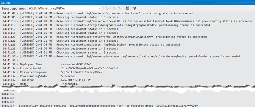

Another option is to start the deployment via right-click in the ARM Visual Studio project:
You will be prompted for the following choices. Note you select a resource group to deploy to, along with the deployment template file (ARMResources.json), and the parameters file (devvalues.parameters.json).
Here we can verify the parameter values, or change one at the last moment if necessary:
This is the final prompt for the administrator password since the value is not stored in a parameter:

Monitoring Deployment Progress
Azure Portal
In the Azure portal, you can check the status of a deployment (and history) from “Deployments” within the resource group:
Visual Studio
If you are deploying from within Visual Studio, you can check the Output window. If there is an error, it will be shown.
You can also grab copies of the deployment files from the \bin\ folder underneath where you keep your Visual Studio project. This is useful for tracking history of deployments, or to use for the next deployment (to Test or Prod, for instance).
