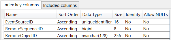

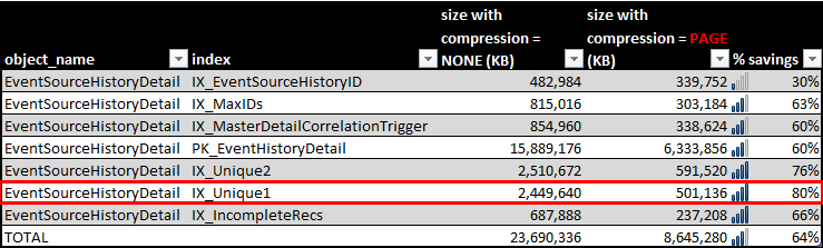

Page Compression for EventSourceHistoryDetail
The data types for the three columns in that index are uniqueidentifier, bigint, and nvarchar(128).
EventSourceHistoryDetail Index Data Types
The EventSourceID and RemoteObjectID columns contain relatively few unique values, and while RemoteSequenceID contains unique values, they are bigints (which means the value 1 eats up 8 bytes of space). Let's look at those three values across the SQL Server Data Compression spectrum.

Page compression saves an impressive amount of space with this data because it's able to store the EventSourceID and RemoteObjectID once on this page instead of for each row with those same values. These particular columns had a combined size of 96; now it's 1.In ConclusionAs I mentioned, you don't need to know about DBCC PAGE in order to apply compression to a SQL Server database. You can, however, use it to see how specific data is being compressed for a deeper understanding of data compression. If you're not sure about the savings you're seeing, you can use it to verify what SQL Server is doing at the page level. Visualizing data compression provided a sanity check for me at times. Having explored various data types at different compression levels, I feel like I just "get it" more now that I've seen it.If you're just starting out with compression or haven't looked into it because it was an Enterprise Edition feature, you should know that it's available beyond Enterprise Edition in SQL Server 2016 SP 1. Now is the perfect time to master data compression!
