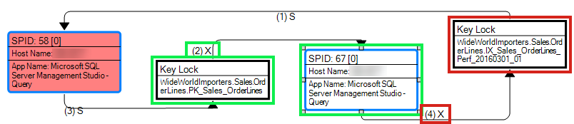

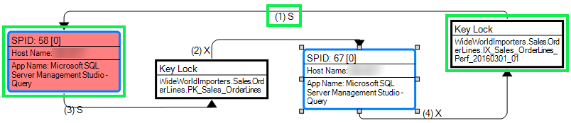

If you open a deadlock with Plan Explorer, the telltale sign a key lookup is involved is a key lock against a clustered index, and a key lock against a non-clustered index. These are visible on both the diagram and tree view as shown below:
With integrated Plan Explorer, you can quickly confirm by clicking the "View" button on the non-clustered index row (shown above) and it will open the query plan captured automatically when the deadlock occurred. If no plan was captured, it will auto-request an estimated plan.

I'll walk through the sequence of events leading to the deadlock, using Plan Explorer's deadlock and plan diagrams to illustrate each step. The nodes outlined in green (or red) are those that are relevant for that step, and the number in parenthesis on each deadlock connector line represents the order in which the lock was acquired.

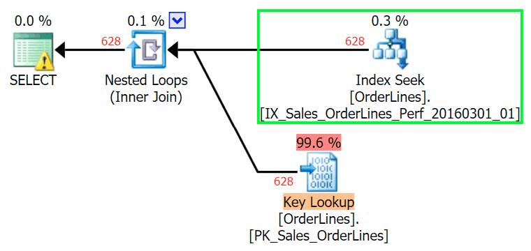

- The SELECT retrieves data from the non-clustered index via a Seek. A shared lock is taken on one or more pages.

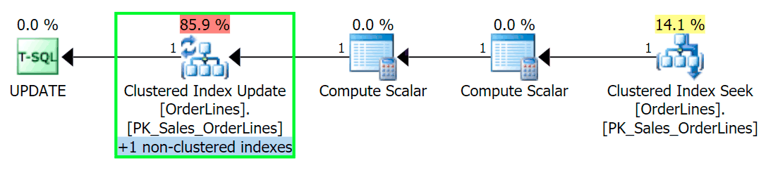

- The UPDATE takes an exclusive lock on the clustered index row. Because at least one of the columns in the non-clustered index is being updated, an exclusive lock is immediately attempted on the non-clustered index row, but it can't be acquired because of the shared lock owned by the SELECT.

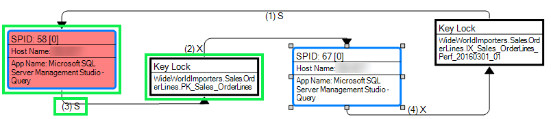

- The Key Lookup tries to acquire a shared lock on the same row in the clustered key currently locked by the UPDATE, but it can't be granted because of its exclusive lock.

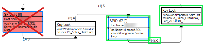

At this point a stalemate exists until the lock monitor thread detects the deadlock, usually within 5 seconds. Inevitably the SELECT will be the loser because the UPDATE will have done more work. (The amount of work done by each process is shown in the Log Used column in the tree view.)
- Once the SELECT thread has been chosen as the deadlock victim and terminated, the UPDATE can successfully acquire the exclusive lock on the non-clustered row and update it.
In the plan diagram above, note that the number of non-clustered index updates associated with an UPDATE or DELETE is always highlighted in blue below the Clustered Index Update operator, with the list of affected index names shown in the tooltip.

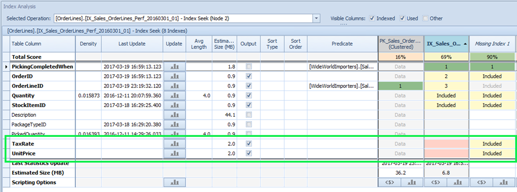

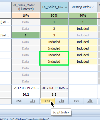

The key lookup happens because the non-clustered index doesn't include, or cover, all of the columns used by the query. This is apparent on the Index Analysis tab – note the light red cells for Tax Rate and Unit Price:
For more details on how to use the Index Analysis module, see Aaron Bertrand's posts: Index Analysis and SQL Sentry Plan Explorer 3.0 Demo Kit .
Include the Columns
The easy solution is to add these as included columns to the existing index, which will eliminate the lookup. I can do this by selecting the dropdowns for both red cells and selecting the "Included" option, then clicking the Script Index (<S>) button (see image at right).
We also show a missing index recommendation found by the optimizer, but there's no point in creating an entirely new index when only these two columns are needed.
NOTE: Before adding included columns, you should first consider the number of rows in the index, the total size of the columns, and the level of DML activity on the table to determine whether the additional overhead of a larger index will be justified.
