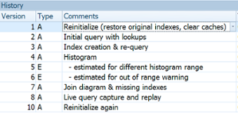

You can move to any History Version # referenced below simply by clicking on that row in the History window.
History Version 1 - Reinitialize
This entry isn't used for anything plan- or demo-related, but simply to reset the system to the beginning of your demo - it clears the procedure cache and buffer pool, and changes indexes back to how they started. It uses this procedure (click to show):

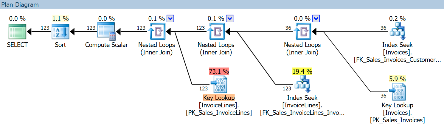

In the first demo, we run a query that attempts a join between Invoices
and InvoiceLines
, intentionally constructed to yield two key lookups and a sort:

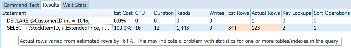

After running this query (or moving to item #2 in the session file), you can show the information in the statement grid that you won't get from Management Studio by default, such as CPU, Duration, and Reads. You can also show that we highlight the difference between estimated rows and actual rows when they differ by a large enough percent. This discrepancy can be caused by a variety of things, including:
- Out-of-date statistics - usually the most common cause is that the current statistics do not reflect the actual data. You can resolve this using UPDATE STATISTICS (and you can see more information about statistics on the Index Analysis tab, described later).
- No histogram - perhaps there are no stats already and auto-create statistics is disabled, or columns are not in the leading key of the index, the optimizer may need to use density or average distribution information instead. This can lead to very vague, ballpark guesses.
- Sheer complexity - in some cases the optimizer just has too much work to do trying to determine estimates, for example if filtering is occurring against many columns or using many predicates.
Statistics discrepancies are important to note at the statement level, but they are important at the individual operator level as well. We highlight these discrepancies in red on the plan diagram for an actual plan, so you can see exactly where incorrect estimates are happening. These can cascade from one operator throughout an entire plan, causing the optimizer to make sub-optimal decisions.
The grid also includes certain columns dynamically, only when they're relevant (in this case, Key Lookups and Sort Operations). You can show the ability to add other columns at will by right-clicking the column header, choosing Column Chooser, and dragging any column onto the grid. The metrics you see should look something like this in this case:

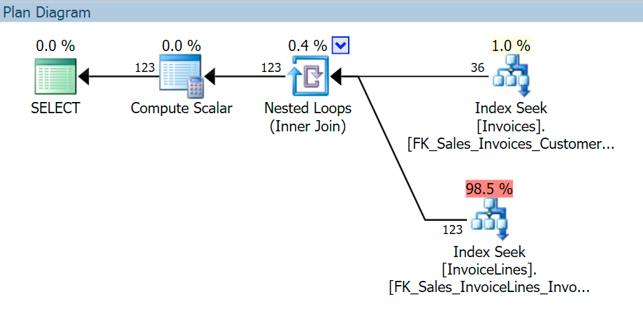

Moving to the Plan Diagram, you can show that color is used to indicate problem areas. There are two Key Lookups in this plan, but one clearly has an overwhelming estimated cost. You can stress that these costs are estimated and may not reflect reality at all (something we'll see in a different plan below), but they can still be used as a rough guideline on where to focus.
The Plan Tree and Top Operations tabs have some useful information (for example, the Actual Executions column shows part of the reason the highlighted Key Lookup is so expensive). They show essentially the same information; the Plan Tree fixes the grid into a structure like you would see in SHOWPLAN_TEXT
, while Top Operations presents a grid sortable by any column.

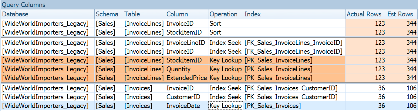

If you switch to the Query Columns tab, you can show how we highlight the columns that made the more expensive Key Lookup necessary. This is to provide some evidence that changing the index to either have these columns in the key or include list will probably help the performance of this query.
Note that when I'm talking about this, I always stress the importance of considering both sides of the workload - while making an index wider can help this one specific query, it might not be run enough to justify the change, and the change may not benefit any other queries, either. Most importantly, changing the index can create a lot more work for all of your write queries, too. (I talk about some of the decision factors, which are relevant both for creating new indexes and changing existing indexes, in the post, Don't just blindly create those "missing" indexes!.)

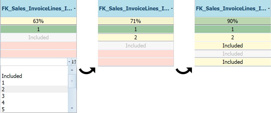

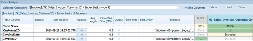

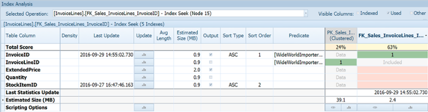

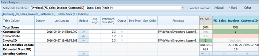

A new feature in Plan Explorer 3.0 is Index Analysis, designed to vastly improve the way you look at queries and consider index improvements. Let's move to that tab and see what we have. The problematic Key Lookup is the one associated with the Index Seek on InvoiceLines, so let's select that operation (Node 15) in the Selected Operation list, and uncheck Other and Indexed from Visible Columns so we can focus on the columns used in this query. You should see something very close to this:
There's a lot of detail here - essentially on the left you have information about the columns, including statistics, estimated size, and whether they are sorted or are included in a predicate.
On the right, you have all of the indexes on the table, starting with the clustered index (if there is one). Next will be the index selected for this specific operation (though sometimes that will be the clustered index). After that, though clipped from the screen shot above, you will see the rest of the indexes on the table, ordered from left to right by what we call "Score." The algorithm for determining an index's score is not public, but you can assume that, for example, a covering index with a leading key column that is used in both a predicate and a sort will score much higher than a non-covering index with a leading key column that is sorted in the wrong direction.
Now, if we look closer at the index that was chosen for this query, we see that it only scored 63%. The reason? It isn't covering. Meaning there are columns missing from the index, causing the key lookup. In the grid, we highlight those for you in salmon, to make it obvious which columns would help make this index better (or to use in a different index, if you wanted to go that way). The functionality we provide here to allow you to fix this, though, is quite a different way to think about index improvement. You can click into any of those missing column cells, make them a part of the index (hypothetically), and see how it improves the score of the index.
Since you know from the left side of the grid (or from the query text) that StockItemID
is both part of the output and part of the ORDER BY
, the first thing you do is change that column so that it is second in the key list. You do that by clicking on the cell and selecting the number 2 (and if the sort order were descending, you'd click the sort icon to change that order). This makes the index score 71%.
The InvoiceLineID
column says it's involved in a predicate, but that's the XML playing tricks on us (if you expand the predicate, you'll see that it's just validating against itself, as part of the nested loops operation). As the clustering key, it's included in this non-clustered index anyway, so you can move on to the other two columns. If key add those to the include list, by clicking the cell and choosing "Included," we see the score change again - this time to 90%.
Not perfect, and keep in mind it won't always be possible to hit 100%, but certainly something we can try to improve the performance of the query. Click on the script button at the bottom left of that column (<s>
), and it will give you a new dialog with a batch of SQL involving a DROP INDEX
/ CREATE INDEX
. You don't have to do anything with this (it will be in the next entry in the History), but mention that you can run this directly here, copy it to a query window to modify before running, or just save it to a text file for later consideration. Click Close.
Before moving on, let's see if you can't improve this query further by removing the other Key Lookup. At the top of the tab, switch the Selected Operation to the other Index Seek (Node 9). You should see something like this:
Again, InvoiceID
is shown with a predicate because of the nested loop, not because it's needed for the index, so you can focus on the other column that makes the Key Lookup necessary - InvoiceDate
. This column is clearly required for output but not involved in any sort operations or predicates, so we can change the column to be included in the index, and watch the score jump from 75% to 100%.
You can show the output in the <s>
dialog, but know that both index scripts will be included in History version 3.

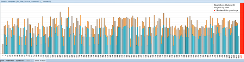

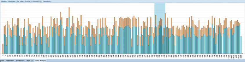

History Versions 4/5/6 - Histogram
Next we can take a look at the histogram, which can be a useful source of information as well. For the foreign key index on Invoices, the distribution is fairly uniform. This query is slightly different in that we're looking for a range of customers. We'll start with a low of 800 and a high of 830 (yielding about 10,000 rows):
DECLARE @CustomerIDLow int = 800, @CustomerIDHigh int = 830;
SELECT
il.StockItemID, il.ExtendedPrice,
i.CustomerID, i.InvoiceID, 0 - il.Quantity, i.InvoiceDate
FROM Sales.InvoiceLines AS il
INNER JOIN Sales.Invoices AS i
ON il.InvoiceID = i.InvoiceID
WHERE i.CustomerID >= @CustomerIDLow
AND i.CustomerID <= @CustomerIDHigh
ORDER BY il.InvoiceID, il.StockItemID;
Look at the Index Analysis tab and make sure that the Index Seek is selected - in this case there is only a seek against Invoices
, while a scan was chosen for InvoiceLines
. You will see that there is a histogram below, with a rather uniform and uninteresting distribution, with a range of values highlighted - this represents the range of the runtime parameters (allowing you to spot parameter sniffing problems, say, where a scan is chosen instead of a seek or vice versa):

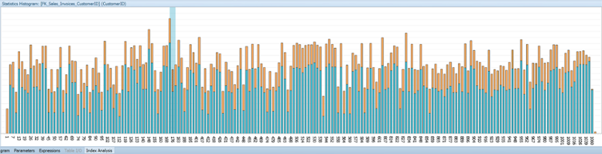

In the Parameters tab next to the Histogram, we can also test other values. For example, you can put 176 as high and low end of the range, click Get Est Plan, and you will end up with a slightly different looking histogram (as shown in History version 5):
And if you repeat that process with values outside of the range, say 1100 and 1120 (to simulate an ascending key problem), you can see we paste a big red warning label there, with a tooltip that describes the problem (this is visible under History version 6):

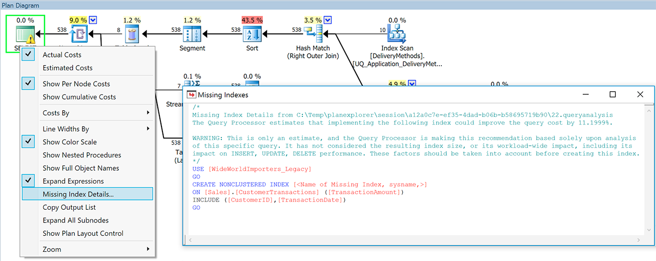

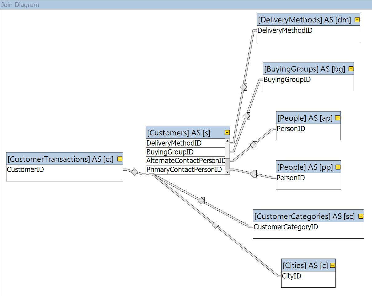

History Version 7 - Join Diagram & Missing Indexes
This is a rather lengthy query adapted from one of the views in the sample database. It demonstrates how you can visualize the tables and relationships involved in a query by moving to the Join Diagram tab. This can be quite useful for detangling and understanding queries involving views, especially when they are nested, as we show the underlying relationships between the base tables:
It also shows our Missing Indexes feature, which you can access by right-clicking the SELECT node on the Plan Diagram (and I'll repeat the warning here, don't just create every missing index recommended to you!):

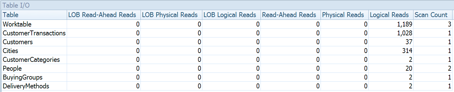

And finally, the Table I/O tab shows how we organize SET STATISTICS IO ON;
data for you in a sortable grid.

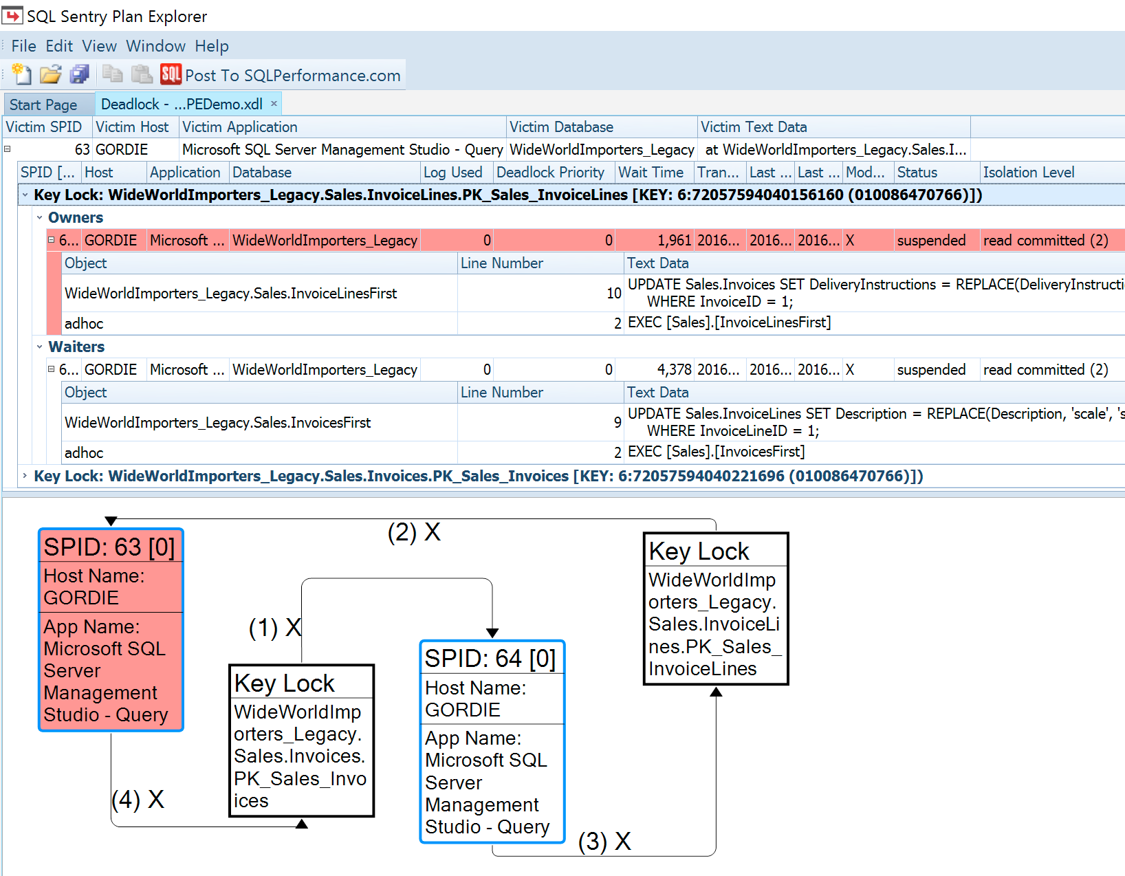

PEDemo.xdl
I created two stored procedures in the sample database to make it easy to show how Plan Explorer can provide a lot of insight about a deadlock. In the screen shot below you can see that we include a grid with information such as isolation level, the statements that deadlocked, and even the procedures they came from - without having to reverse engineer things like ObjectIDs and HobtIDs. Below that there is a deadlock graph with a more intuitive layout than the one you get by default - again no reverse engineering of object names, and the flow clearly indicates the order in which locks were taken - which can help you solve the deadlock quicker.
In this case, the problem is simple - the two stored procedures named in the grid have batches that update two tables in the opposite order. If you wrap those procedure calls in outer transactions, SQL Server has no alternative - it needs to make one batch the victim and let the other one succeed.
