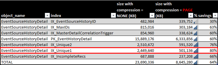

In the "Yes" example below, I estimated savings on a table and discovered that one index would compress by about 80%:
EXEC sys.sp_estimate_data_compression_savings @schema_name = N'dbo'
, @object_name = N'EventSourceHistoryDetail'
, @index_id = NULL
, @partition_number = NULL
, @data_compression = N'PAGE';
Estimating Savings
Savings by Index

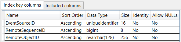

Upon seeing that % savings, I took a closer look at that index. Shown below, it has three columns:
Index Info

Below, you can see in the results that across 253,127 rows, there are only 16 different values for EventSourceID and 241 values for RemoteObjectID. The RemoteObjectID has the potential to have the largest size (256 Bytes). Consequently, being able to refer to those values instead of duplicating them across the quarter million rows will certainly add up to a high % savings in storage space.
Unique Table Data
Furthermore, the RemoteSequenceID
is a bigint
, which uses twice as much space as an int. Row compression is able to store those values more efficiently since they do not require the maximum space required by a bigint
. A value of '2' can use a single byte instead of eight.

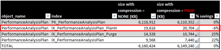

Perhaps most noteworthy about this example is the that the data not only fails to compress well, but that the compressed size is greater than the original.
, @object_name = N'PerformanceAnalysisPlan'
, @index_id = NULL
Estimating SavingsRecall that compression creates an area of metadata for it to work. As a result, that metadata overhead could increase the storage size in some cases.
Savings by Index
Taking a closer look at the index in question reveals that it consists of a plan hash, a binary data type. According to Microsoft documentation, binary data types row compress by removing trailing zeros.

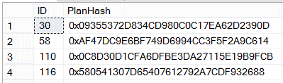

If you're not familiar with what a plan hash is, you might be wondering why it doesn't compress the prefix values. Just because the values are unique doesn't mean they don't share prefix values, right? Due to the nature of a plan hash, this isn't the case.
Plan Hash Data
As shown above, the prefix values for the plan hash are rather limited. There's the 0x, but the remainder of the hash has less to offer for prefixes and dictionary compression methods. Notice that the removal of trailing zeros is not helpful here, either. Row compression is unable to store this more efficiently.
