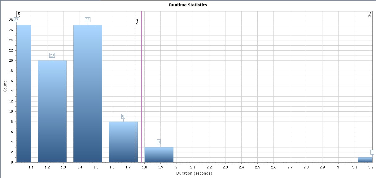

Aggregate View
The “Graph View,” which is also a part of the top tool bar, allows users to switch to an aggregate view. This view gives users a visualization of execution counts for ranges of execution durations, providing an additional high-level view of a statement's performance:
