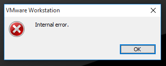

Every so often I need to access a virtual machine using VMware Workstation, but unfortunately it decides that it doesn't want to do any work today and just pops up with a rather unhelpful "Internal Error" message. Thanks for that VMware; most enlightening. I guess I should at least be thankful that it was not an "unexpected error" but then, on the other hand, they must have expected it, so back to square one.
As this has happened quite a few times over the years I thought I should probably document it somewhere to save some poor soul that moment of panic. The more it's documented the easier it is to find; it will also help me as I have a memory like a, like a, you know, one of those thingies. Anyway, the first time I had this error was 30 minutes before a session and a two-word error doesn't give you much to go on.

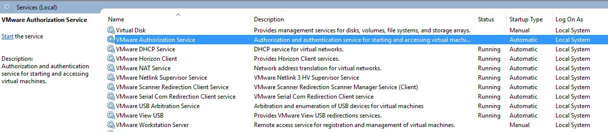

My internal error appeared to be due to a service not running. Again, your mileage may vary, but these are the steps I took:
- Open up Services: Start - Run - Services.msc
- Order Services by Name
- Press "V" to go to the VMware set of services.
- Check to see if there is a VMware service that is not running
- Start the Service
In my case this has always solved the problem. The image below shows that in my case it is the VMware Authorization Service that was not running.
