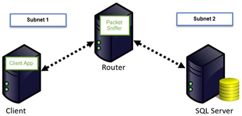

In order to demonstrate just how easy it can be to get hold of the information inside the TDS packets I will be using Network Monitor from Microsoft, this will capture the network packets sent and allow me to see the details of what is being sent. Other tools such as Wireshark will also provide a level of insight into what is being sent between the application and SQL Server. I have configured three Windows Server 2012 R2 systems, one with the client (SQLCMD), one with SQL Server, and finally one which will act as a router between the two subnets that each server is on. This configuration can be seen below;
While this example is simplified, it should be noted that most enterprise grade network equipment and virtualization platforms allow for port mirroring. This is where the traffic on a network port is copied and sent out via another port, normally for monitoring purposes. In Hyper-V it is as simple as setting a dropdown in the Advanced Settings on the Network Port for the VMs.

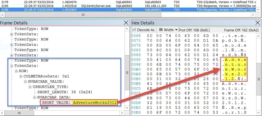

So, once this statement has been issued and we have the results, it is time to look at what we captured in Network Monitor. First of all it is important to understand that we are going to look for a pair of packets, the query we sent and the results that we got. As we can see below, finding the packet can be achieved quite quickly as we know a lot about them already. Namely that it will be using the TDS protocol, and we know where they are originating and their destinations. Once we have the outbound TDS SQL Batch, we can look into the payload of this packet, and it becomes very clear what we just asked for.
Now we just need to locate the Response from the server, again this is easy to do given what we know. And here we can see that the payload contains quite a bit of information about the results that we want, additionally we get a bunch of useful metadata about data types.
The net result of this is that I can glean important information about the system, directly from the results but also metadata that tells me about the schema. From the initial query I will get objects and relationships, then from the response I can get information around the data types that are used along with the actual data that is being returned to the query. In this case database names, however it could be sensitive data such as financial, personal or technical specifications for a new product. If it is in the database and being queried then it is all fair game.

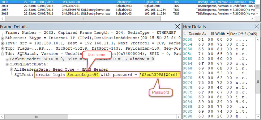

While we can clearly see that we can protect our data and database schema by encrypting our SQL Server connections, it should also be noted that we should think about protecting some of our admin related queries. If you still have applications that need to make use of SQL Logins, you will be pleased to know that SQL Server does not send the username and password in clear text during the authentication process. However, if you are creating logins, then this data will be sent in clear text if the connection is not encrypted. So, if I need to add a SQL Login, I give it a name and then pick a really secure password that no one can guess.
CREATE LOGIN SecureLogin99
WITH PASSWORD = '$3cuR3P@$$W0rd!'
When we send this command to the SQL Server to create the login, if the connection is not encrypted, then like with the previous statement we will see the payload.
As a result our system security is not quite as strong as we would like it to be, and that secure password that we created for our SQL Login is not so secure. Anyone who captured the packet with the T-SQL statement creating the login will now have both the login name, and the password. Additionally they will know which server it is on and can now go and log in with ease.
