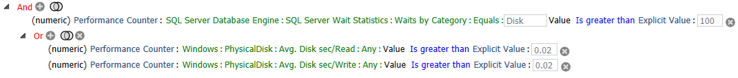

This same logic is used in the existing High Disk Waits and Latency condition:
Existing example of an AND/OR logic combination
The custom condition above corresponds to the truth table shown below:
Truth Table: And (Or) Combination
| A | B | C | (A ∧ (B ∨ C)) |
| False | False | False | False |
| False | False | True | False |
| False | True | False | False |
| False | True | True | False |
| True | False | False | False |
| True | False | True | True |
| True | True | False | True |
| True | True | True | True |
Conditional Operator: And (Or) Combination
First Condition A = 1? | Second Condition B = 2? | Third Condition C = 3? | Result | Condition |
| False | Skipped | Skipped | False |  |
| True | False | False | False |  |
| True | False | True | True |  |
| True | True | Skipped | True |  |

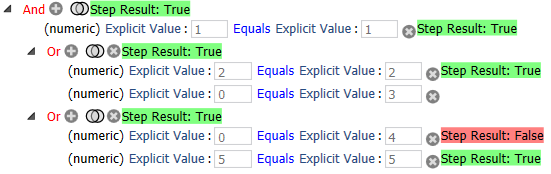

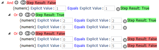

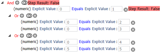

Conditional Operator: And ((Or) And (Or)) Combination

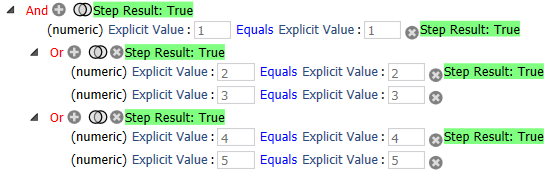

In the first sixteen rows, A is False, and because of the "AND" logic, this means that no matter what the values of B, C, D, and E are, the overall condition result will be False, therefore those condition steps are skipped by SQL Sentry during the evaluation.
| A | B | C | D | E | Result | Condition |
| False | - | - | - | - | False |  |
| True | False | False | - | - | False |  |
| True | False | True | False | False | False |  |
| True | False | True | False | True | True |  |
| True | False | True | True | - | True |  |
| True | True | - | False | False | False |  |
| True | True | - | False | True | True |  |
| True | True | - | True | - | True |  |

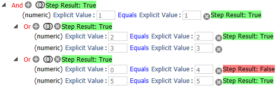

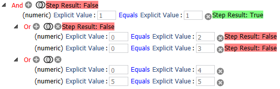

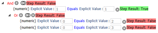

Grouping
One thing that might cause some confusion when you first get started with Custom Conditions is making sure that your logic is properly configured in SQL Sentry. The "Add a New Condition Group" is like adding a new set of parentheses. You need to ensure that you are on the correct step/level when adding a new group. In the example above we had (A ∧ ((B ∨ C) ∧ (D ∨ E))), but if that second "OR" group had been added as a new group to the "OR" instead of the "AND" level, we would have something very different.
Grouping Example 1
Grouping 1
Grouping Example 2
(A ∧ ((B ∨ C) ∨ (D ∨ E)))
Grouping 2
Grouping Example 3
(A ∧ ((B ∨ C ∨ D ∨ E)))
Grouping 3 (Essentially the same outcomes as Grouping 2)
In Grouping 2 and Grouping 3, if A is true, then the overall condition is true as long as any other single condition (B, C, D, or E) is true.

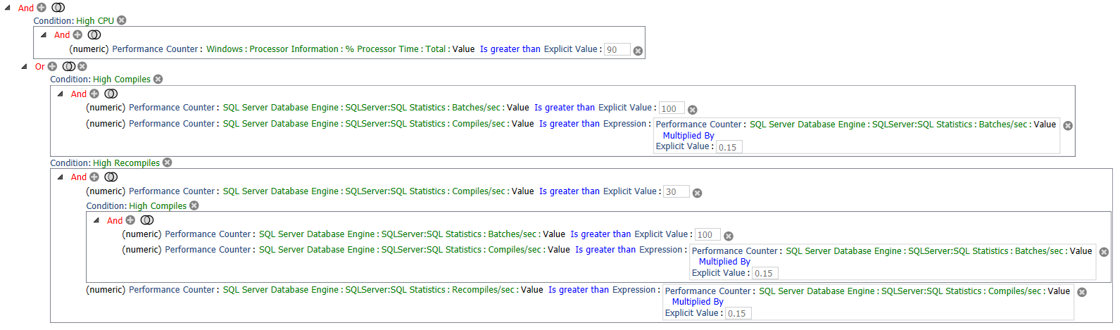

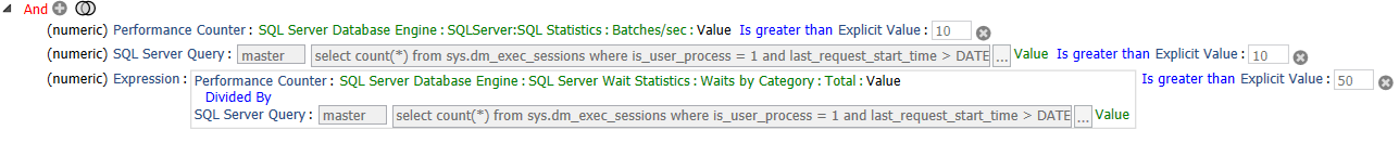

Complex Logic
Not all custom conditions will require complex logic to create useful alerts, in fact, many of the custom conditions you'll see only require one or two steps to build a crucial alert. As shown in the first few truth tables at the beginning of this post, those custom conditions are easy to build and are quickly tested and validated. Sometimes, however, you will want to create custom conditions with more complicated logic. The High Compiles + High CPU condition is an excellent example of what you can accomplish with nested logic in SQL Sentry Custom Conditions:
Existing example of multiple steps & nested logic in Custom Conditions
Also, worth noting about the High Compiles + High CPU condition is that it uses other custom conditions as building blocks. You can build a custom condition that is a combination of existing custom conditions. As mentioned earlier, I used the explicit values so I could create examples for all combinations, but it's worth pointing out that you can have combinations of Performance Counters, SQL Server Queries, Repository Queries, WMI Queries, Expressions, and Duration in there as well.
