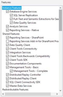

At right is the set of options (all but one) that get selected when you choose All Features with Defaults.
I can't imagine a scenario where you want every single feature available to be running on the same machine; even in the rare case where this is the requirement, it's kind of like my arguments about SELECT *: if you really, really want everything, it should be an intentional choice, and it should be a little bit harder to do.

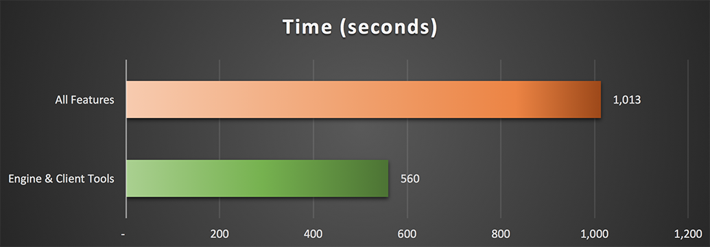

For the non-interactive portion of Setup, it took 16 minutes and 53 seconds to install all features, while it only took 9 minutes and 20 seconds to install the engine and client tools:
So, clearly, this can add to the amount of time you're taking, and the extra 20 seconds it would have taken you to manually select the options you wanted would easily have paid for itself. (This also holds true for unattended installs - even though you're not waiting on those, it's still time each system has to spend configuring services and features that may never even be used - and if you're adding a minute per install, and you're deploying 100 or 1,000 instances...)

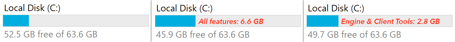

Not surprisingly, installing more features consumes more disk space. It's not quite as bloated as Windows itself has become, but there is a stark difference between a minimal SQL Server install and the "All Features" option. I created a new Windows 10 VM with nothing (aside from the .NET 3.5 feature) installed, took a snapshot, then ran both types of setup after restoring to the snap. Here was the impact to disk space from initial (left) to All Features (middle) and Engine & Client Tools only (right):
So an additional 3.8 GB of space is required to house All Features, even if you're not going to use them. Again, given more time, I could have tested all permutations, to determine the heaviest hitters.
