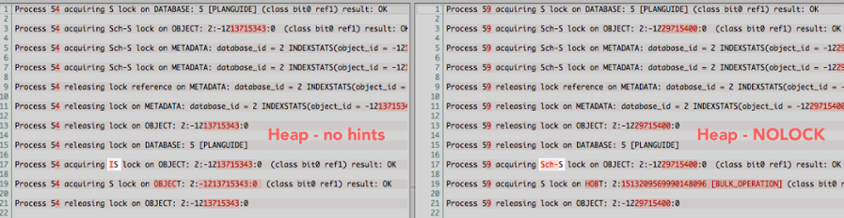

Now let's compare the differences in the TF1200 output. For the heap (no hints on the left, NOLOCK on the right):
Diff between TF1200 output for a heap with no hints (left) and NOLOCK (right)

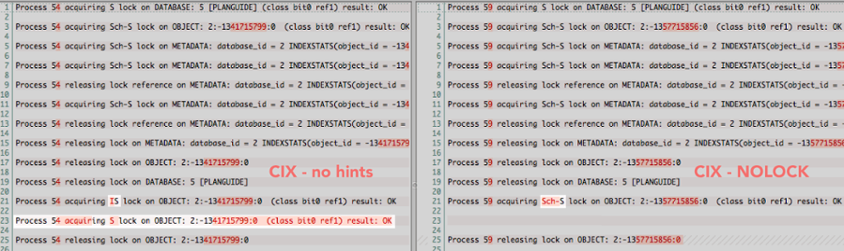

And for the clustered index (again, no hints on the left, NOLOCK on the right):
Diff between TF1200 output for a clustered index with no hints (left) and NOLOCK (right)
I've highlighted the few, subtle differences in the nature of the locks taken (ignoring all the diffs due to different session and object IDs), and while I will concede that the locking patterns are not identical, there's nothing here that I would characterize as a significant difference in overhead. In both cases an intent shared lock is taken under read committed while it's a schema stability lock under read uncommitted; with the clustered index there's one additional shared lock.
Both with and without a clustered index, and both with and without the NOLOCK hint, the output from sys.dm_tran_locks is always the same in all four cases, showing no object-specific locks at the transaction level:

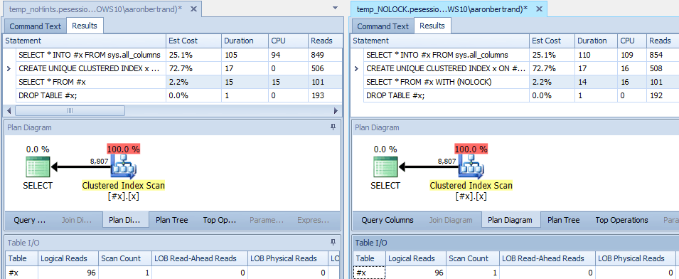

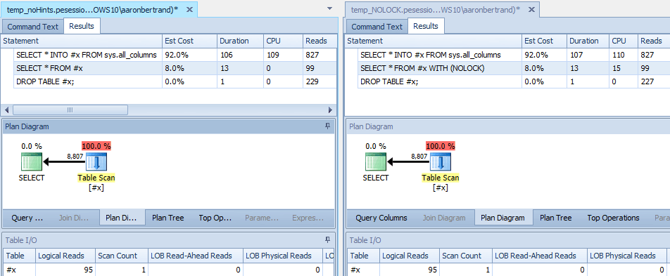

Finally, we can also compare the plans and runtime metrics using SQL Sentry Plan Explorer, and see that we get the same plan and very similar runtime metrics such as duration and I/O. For the heap (no hints on the left, NOLOCK on the right):
Plans and runtime metrics for queries against a heap
And with a clustered index (again, no hints on the left, NOLOCK on the right):
Plans and runtime metrics for queries against a clustered index
You may be shocked to observe that the NOLOCK version of the query isn't any faster - because, deep down, aside from the minor differences highlighted above, it really doesn't change anything by adding the NOLOCK hint.
