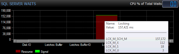

We've recently come across multiple customers who have had excessively high LCK_M_SCH_M
waits. These surface in sys.dm_os_wait_stats
, but much more visibly in the SQL Sentry Performance Advisor dashboard:
Upon digging deeper, we observed the following resource_description
in sys.dm_os_waiting_tasks
metadatalock subresource=LOGIN_STATS classid=$login_stats_id = 65536 dbid=1 id=lock54db84b00 mode=Sch-M
Other than seeing high waits in the DMVs (something will always be your top wait), the symptom in general of these waits will likely be significantly long processing of logins, potentially leading to timeouts. This will be especially true if your applications perform a high number of rapid login/logout operations and when different concurrent clients are using the same login; this was the case with each customer we worked with.

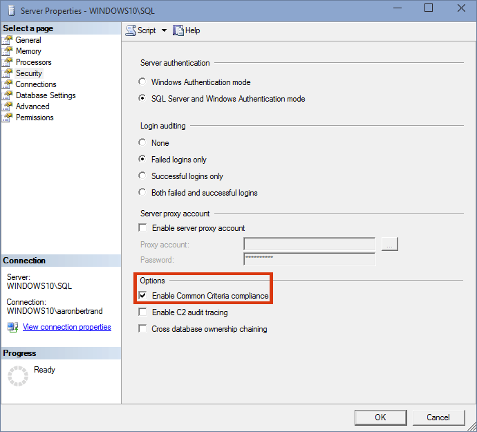

I'll save you the suspense or the details involved with all of our testing; the feature that turned out to be causing the problem was an auditing feature, Common Criteria compliance. In a nutshell, the reason is that, with this feature enabled, SQL Server maintains statistics in a system table about each login - things like last success, last failure, and number of retries. With a high number of login events by the same login, there is contention on that row in the system table, since a lock must be taken to update the information in a transaction, and a log flush is forced after each commit (so anything that can slow down log flushes could also contribute to and exacerbate the problem).
You can check if this is enabled in server properties / security:
Or by looking at the configuration settings for the server:

None of these customers had this setting enabled intentionally; they didn't remember turning it on, and could offer no explanation as to why it was enabled.
Initially, we turned the setting off, and didn't observe any changes in the behavior. We then restarted the SQL Server service, and still didn't see any change - the waits went down slightly, but they gradually crept back up. We didn't see any true relief from the symptom until we completely rebooted the server. This is explained in the documentation (emphasis mine):
The setting takes effect after the server is restarted.
Through more testing in the reverse direction (turning the setting *on*), we observed that the symptoms would not necessarily reveal themselves immediately. So it's important to note that you may start seeing these symptoms weeks or months after turning the feature on - this made the correlation difficult to track down for our customers, and may prevent it from being immediately obvious to you, too.
