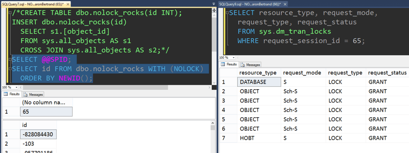

It really is too bad that they named this hint NOLOCK. The semantics of read uncommitted don't actually mean "take zero locks" - they actually mean "take no shared locks." I have seen many people surprised to see rows in sys.dm_tran_locks for a query that is running under read uncommitted. Here is a quick example, where we can see Sch-S (schema stability) and other locks taken out for an object, even though NOLOCK is used:
Sch-S locks showing even under read uncommitted
These aren't held for the duration of the transaction, but the locks are maintained while the query is running. What does this mean? Well, if you have lots of users running read-only queries under NOLOCK, you may still have issues "cutting in line" to make any changes to the table or its indexes, because you will be blocked by Sch-S. It is a good thing to be conscious of this issue - "NOLOCK" in this case isn't exactly working as advertised.

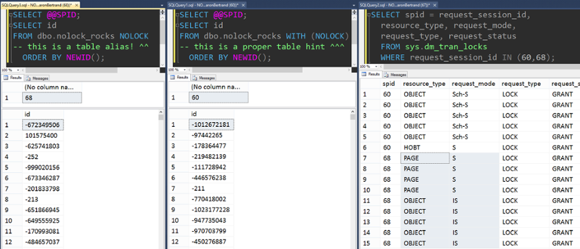

If you insist on using the hint at the table level, you need to be very careful about the syntax. Compare the following, both of which are *allowed* syntax, but with markedly different behavior.
Important differences in query syntax - alias vs. hint
On the left, session 68 just used FROM dbo.tablename NOLOCK - as you can see from the results, this was actually interpreted as a table alias, not a hint, and as a result, it took out shared and intent shared locks at the page and object level - which is not behaving the same way as the author likely expected. So please, always use the fully explicit form, FROM dbo.tablename [AS alias] WITH (NOLOCK).
