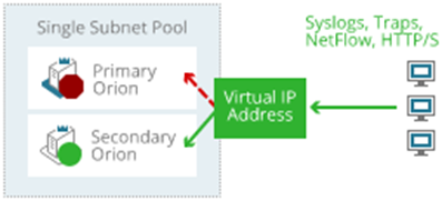

Single subnet
When you configure your environment for SolarWinds Platform High Availability on a single subnet, you place your secondary server on the same subnet as the primary server.
These two servers are then added to a High Availability pool and placed behind a Virtual IP (VIP) address so the servers in the HA pool can share the same incoming IP address.
Once the servers are part of the High Availability pool, all incoming requests through the VIP can be addressed by the server that is currently active.

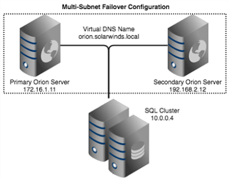

Multiple subnets
When configuring High Availability across multiple subnets there are additional configuration items available. A virtual hostname is used when configuring HA across multiple subnets. During the pool creation, you can choose your DNS settings to manage the creation of the virtual hostname.
Just to note, a virtual DNS hostname is completely optional. It’s not at all required and provided simply as a convenience mechanism for accessing the ‘active’ member through a consistent URL or FQDN. Some customers prefer not to use DNS, and instead access the individual servers through each of their unique IPs or hostnames. If this applies to you, simply select ‘other’ when asked which DNS server type you would like to use with HA. This is the same option customers can use if they run a DNS server that is not BIND compatible or Microsoft DNS.
DNS can also be used by some devices to send Syslog, SNMP Traps, or Flow to a poller in a multi-subnet failover configuration, also in the event a load balancer is unavailable. If you have your own solution for directing incoming traffic to the active Orion server, then there's really no need to configure Orion HA to update DNS records.

Ok, now that we have the how when why, and where covered, let’s look at the database aspects of failover scenarios. In very simple terms, both the primary and secondary servers must be able to connect to your SQL database.
- The SQL server does not need to reside on the same subnet as either the primary or secondary servers.
- Both primary and secondary servers must be able to connect to your database.
- SolarWinds does not provide failover support for the database.
SQL AlwaysOn is the recommended solution for HA, although SQL Clustering is another popular option. In fact, there is no special configuration on the Solarwinds Platform side needed. Simply specify the listener name of the SQL AlwaysOn availability group rather than the SQL instance name in the database step of Configuration Wizard and away you go.
