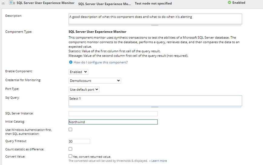

Configure the SQL User Experience Component
When you add the SQL User Experience Monitor Component to a SAM Template, you are presented with the below form. To get info on all fields, please see https://documentation.solarwinds.com/en/success_center/sam/content/sam-sql-server-user-experience-monitor-sw3308.htm, but I will go through a few of them.
Description – I like to add a good description of what this component does and what to do when an alert is triggered here. I do this on all components. In 6 months, you will have forgotten, and the people receiving the alert will most likely not know what this is all about, so I send this text in the alert email. It could also be a link to a KB.
Credentials for Monitoring – An account that has read-permission on the database
Port and SQL Server Instance – You don't have to do anything if you use a SQL default instance. If you have a named Instance and SQL Browser service available, just fill in the Instance. If that does not work and the SQL Instance listens on a non-standard port, put in the Port Number by changing Port Type from “Use Default Port” to “Use Static Port” and add the port number:
Initial Catalog – What database the query should be running against. You cannot use “USE [DBName];” in the query.
Use Windows Authentication first, then SQL authentication – Check the box if the credentials you are using are a Windows/active directory account. It will still work, but you will get clutter in the log files. It’s just wrong.
