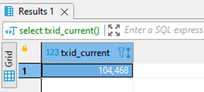

Every transaction occurring on a PostgreSQL installation is assigned a unique numeric identifier. This identifier is a 32-bit integer and monotonically increases as transactions occur. You can use the function txid_current () to find the current transaction ID. Note that calling this function increases the transaction ID of the database.
select txid_current();
The reason this transaction ID is important to know about is because it’s used to keep track of which rows are visible to the PostgreSQL MVCC system.

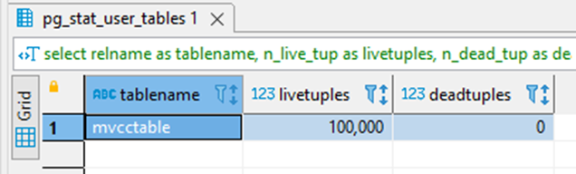

Rows in a table are either a current row (called ‘alive’) or a previous version that is no longer needed (called ‘dead’). The pg_stat_user_tables system table can be queried to find the number of live and dead rows for a given table. The following code queries the system table to show how many alive and dead rows are in the mvcctable:
select
relname as tablename,
n_live_tup as livetuples,
n_dead_tup as deadtuples
from
pg_stat_user_tables
where
relname = 'mvcctable';

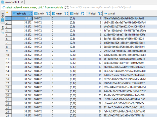

The following query returns all the rows from the mvcctable along with four hidden system columns:
select
tableoid,
xmin,
xmax,
ctid,
from
mvcctable;
You can see the transaction identifier was set to 104472 for the first transaction that inserted the original 100,000 rows into this table. None of these records have been modified yet, so the xmax values are set to 0.

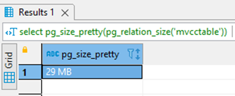

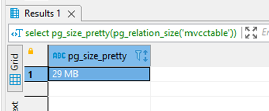

One final piece of background information is you can use the pg_size_pretty function and pass in the name of the table to find the table size. The following code shows this for the mvcctable:
select pg_size_pretty(pg_relation_size('mvcctable'));

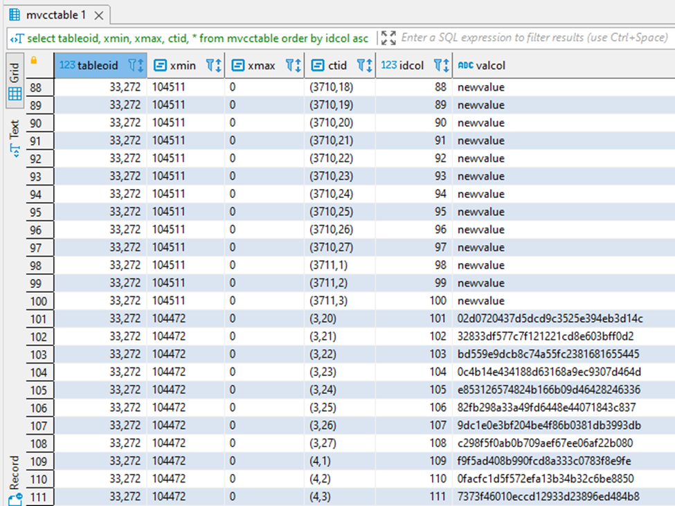

The simple test scenario to show MVCC in action is to have two connection windows; in the first window, start an explicit transaction and run an update command on rows without committing the transaction, and in the second window, run a select statement to see what happens when there’s a concurrent update.
The code for the first window is below. It updates the first 100 rows of the mvcctable to set the valcol to ‘newvalue’ and then leaves the transaction open:
begin;
update mvcctable
set valcol = 'newvalue'
where idcol <= 100;</pre>The select query for the second window selects the first 100 rows:select *
from mvcctable
The query returns instantly and returns the state of the 100 rows PRIOR to the other transaction updating them (as read committed doesn’t allow ‘dirty reads,’ and in fact, Postgres doesn’t allow them even if read uncommitted is used). The magic of MVCC is it compares the current transaction ID of the database to the xmin and xmax values for the rows being queried in the mvcctable and returns the correct ones. As the updating transaction hasn’t been committed yet, the second query isn’t permitted to see the updated rows.Back in the first window, with the still-open transaction, I’ll run the code below:select
tableoid,
xmin,
xmax,
ctid,
from
mvcctable
order by idcol asc;

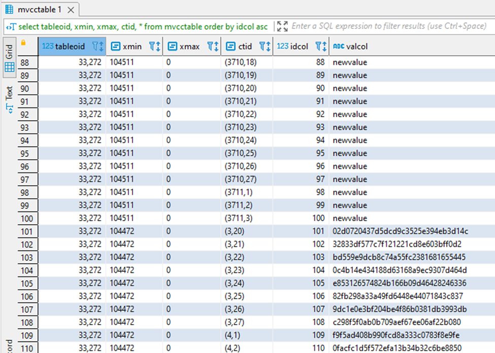

You can see the rows with idcol values 1 through 100 have had their valcol value updated to ‘newvalue’ and have a new xmin value, which represents the transaction ID of the still-open transaction which inserted those new versions. The ctid values (page number and row index on the page) have also been updated to represent the location of the new records. MVCC made sure this query returned the new rows and didn’t see the old versions.

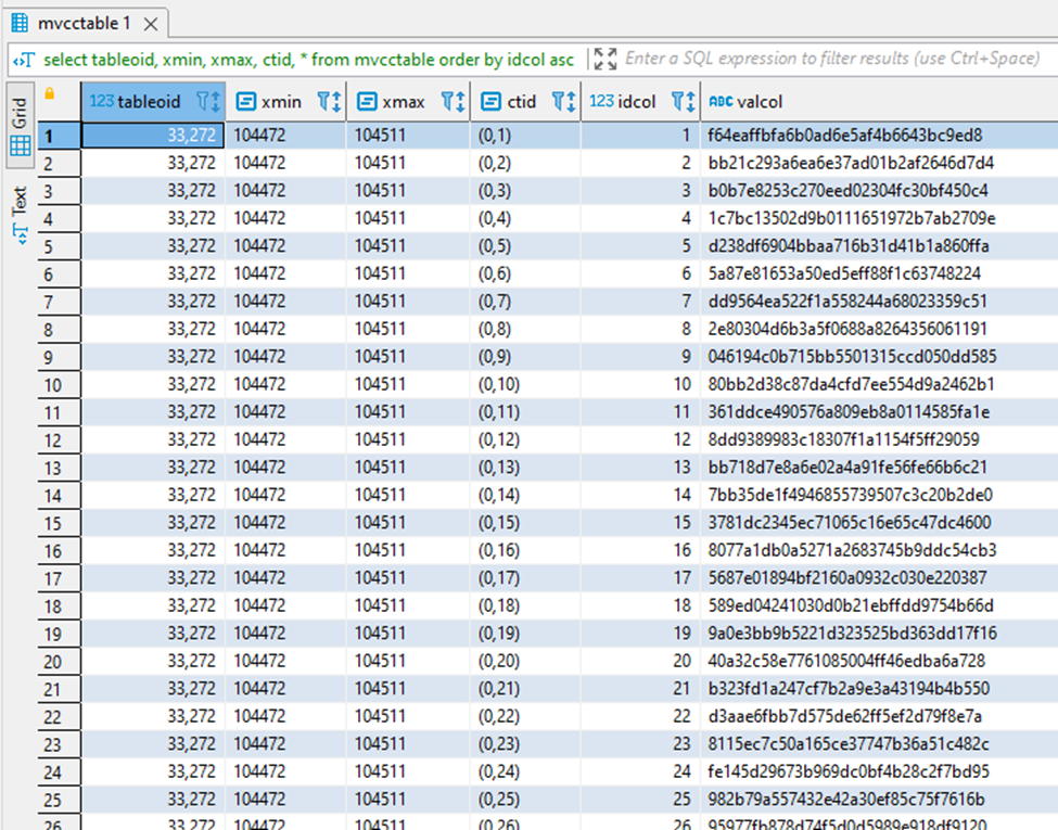

And then if I run the same code in the second window:
select
tableoid,
xmin,
xmax,
ctid,
from
mvcctable
order by idcol asc
You can see the original 100 rows have an xmax value of transaction ID 104511, which is the same transaction ID in the xmin column for the 100 new rows from the update statement.

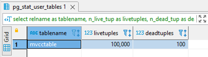

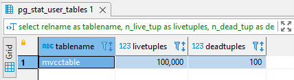

Querying pg_stat_user_tables again shows there are now 100 dead rows in the mvcctable:
select
from
pg_stat_user_tables
where

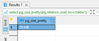

Now I’ll build on the previous example and show how VACUUM can affect table size and the number of dead rows. Querying pg_stat_user_tables and pg_size_pretty shows the mvcctable has 100,000 rows and 100 of them are marked as dead, and the table is 29MB in size:
select
from
pg_stat_user_tables
where

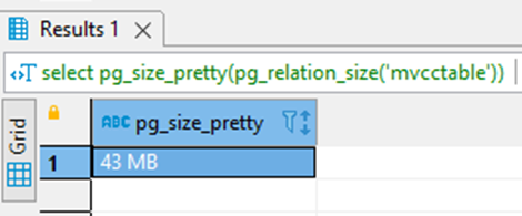

The following update statement creates 50,000 more dead rows in the table:
update mvcctable
set valcol = 'MassiveUpdate'
where idcol <= 50000;</pre>Querying pg_size_pretty again shows the mvcctable has grown to 43MB in size:select pg_size_pretty(pg_relation_size('mvcctable'));

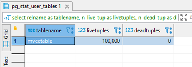

The following code runs the VACUUM process for the mvcctable:
vacuum mvcctable;
And querying pg_stat_user_tables again shows all the dead rows have been removed:
select
from
pg_stat_user_tables
where

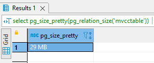

However, the table is still the same size:
