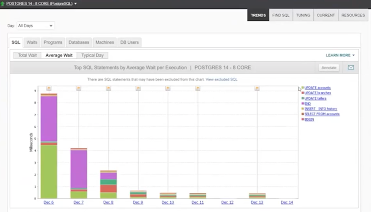

DPAs Top SQL Average Wait Time dashboard below shows my PostgreSQL tuning journey. Taking a few days to reduce transaction throughput from seconds to sub-millisecond.
Figure 1: Database Performance Analyzer Average Wait Time
Day 1: Use PGTune to get off the default PostgreSQL configuration settings
I first changed the default PostgreSQL configuration using workload and hardware-specific recommendations from a free online service called PGTune. That made a big difference, as you can see by comparing Dec. 6 vs. Dec. 7 average wait time above.

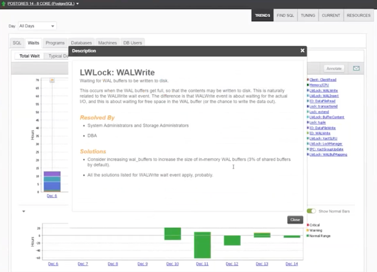

DPAs Total Wait Time dashboard below shows me PostgreSQL write-ahead logging (WAL) is consuming a lot of time:
Figure 2: Total Wait Time—WAL writes taking a lot of time on December 7.
The dashboard also provides recommendations on what configuration settings I should consider changing. I found this helpful as I climbed the PostgreSQL tuning learning curve:
Figure 3: Database Performance Analyzer Tuning Recommendations
Following the advice DPA provided, I made several changes:
- Increased shared and WAL buffer sizes
- Moved the WAL to another location (this made a huge difference)
- Changed the auto-fill factor from 100 to 90 to reduce buffer contention
- Modified application code to limit the number of concurrent sessions
As shown in Figure 1 above, these changes reduced average wait times by 8x from Dec. 7 to Dec. 10 and enabled me to achieve my sub-millisecond transaction performance goal. Note: You can watch a video of this Wait Time Analysis journey here.

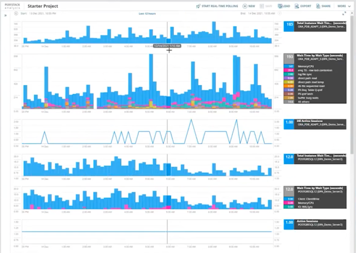

One helpful insight, especially during parallel testing, is the ability to view Oracle vs. PostgreSQL performance on the same dashboard. DPA supports both PostgreSQL and Oracle (and many other DBMSs), making it possible to see wait time history in PostgreSQL vs. Oracle:
Figure 4: Comparing Wait Time history from Oracle vs. PostgreSQL
Using a single tool to monitor performance of both databases enables me to normalize my Oracle versus PostgreSQL performance tuning and makes it much easier to understand performance profile differences.

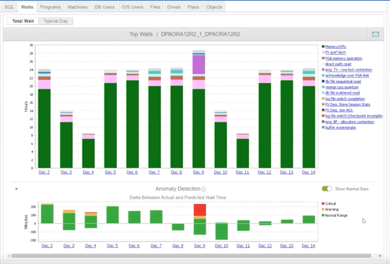

You can also use DPA for anomaly detection. It will tell you when things are deviating from the norm. For example, the Oracle wait time data on December 9 in the graph below catches my attention because it’s way out of bounds and is not typical of a Wednesday.
Figure 5: Wait time anomaly visualization in DPA
From there, you can drill down into the day or the hours of the day when the anomaly occurred and explore the specific SQL statements that contributed to the anomaly, the client machines that issued the statements, the resources used, and so on.
