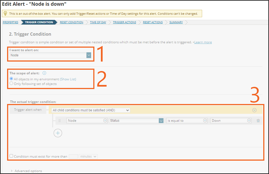

With that covered, let's have a look at some Out-of-the-box alerts. Below is the Trigger Condition page for this out of the box alert. The first thing you'll notice is that you can't edit it, as system alerts are locked for editing. One of the first things you should do when you purchase SolarWinds is to 'Duplicate and Edit' any system alerts so that they are editable and disable the original.
Let's point and problems going through each numbered section
- The Context: No problems here.

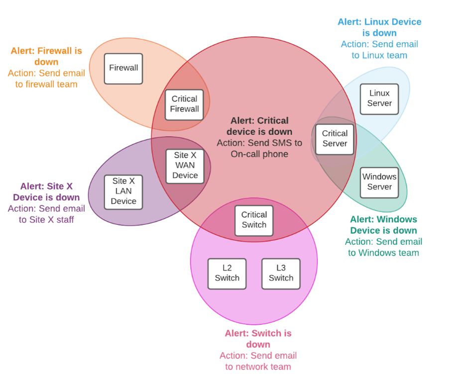

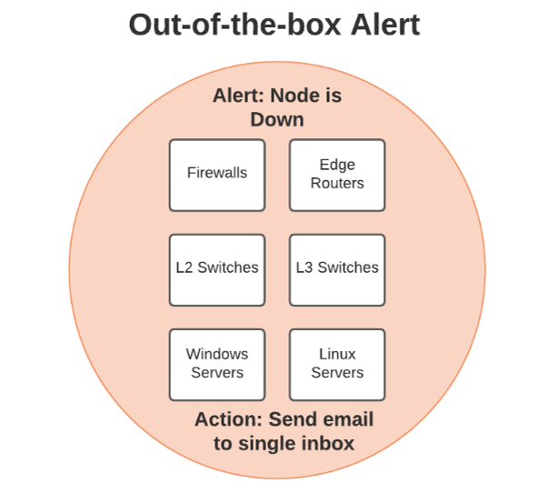

- The Scope: Here you can see there is no scope defined, and this alert will fire for all monitored nodes. If this seems fine, as yourself: Would your actions to a Domain Controller going down in the same be the same as if a firewall went down? Because of this, your alerts should have a clear scope to them to help with troubleshooting.
- The Trigger: While 'Status is equal to down' is fine, we have to consider that we often see devices go down for a short period due to network blips or restarts and these don't necessarily warrant a human action. What we can do is add a delay to the trigger, using the section at the very bottom. This way it will only alert us if the device goes down and STAYS down.

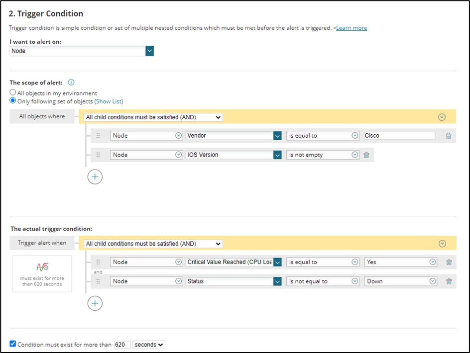

Let's have a look at a better Condition from one of the alerts in the Prosperon Best Practices and you can see that this is very specific alert designed to tell our network engineers when an active Cisco device has a high CPU usage that has persisted longer than 10 minutes:
One key thing to note about this alert is that while it is based on CPU usage of the node, there this NO hard-coded CPU value in the alert condition. Instead, it is using the node threshold to decide whether or not to alert, allowing you more control over individual triggers for nodes.

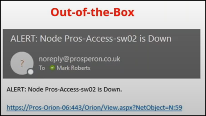

First, let's look at an example of a poor, out-of-the-box alert. As you can see, it does have some information such as the node name, the status of the node and a link to the node itself but it has many problems. First, we have no concept about what this device is. Sure, there is a chance that you just recognize the name of the node and can identify it that way, but especially for people who are newer to the organisation that won't be the case. Second, we can see that there is a duplication of information across the subject and body, with no increase in detail. Finally, there is no real way to visually distinguish this alert from the many others you may be receiving on a daily basis.

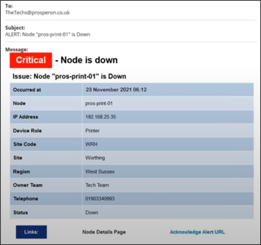

Now, we can see a much better example of a best practice alert email that we use internally at Prosperon. First, we can see that the layout allows for more information to be included without increasing the confusion about the key matters. Secondly, this information can include this like what the Device Role is, the location of the device (Useful for those jobs where you have to physically go and reboot), as well as links not only to the node page but also to the acknowledgement page that you can easily access once you are working on the resolution. Finally, we have a bright red icon that allows us to, at a glance, understand that this is a critical alert and should be treated as such.

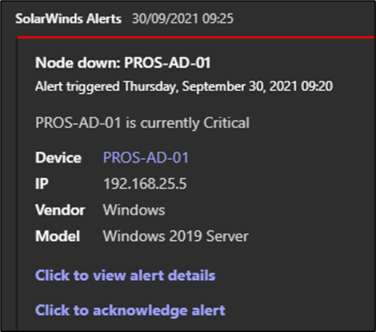

As you can see here, the same tips have been applied to a Teams notification that is created using the 'Send a GET or POST request' action. This method of alerting is becoming more and more common for customers who are using corporate instant messing services:
