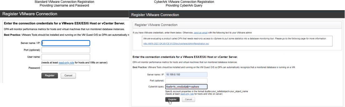

When registering access to the above resources, DPA will no longer ask for usernames and passwords. Instead, DPA will require you to provide the reference to how the credential is stored in CyberArk.
The below picture identifies the difference between registering a connection to VMware the standard way with usernames and passwords vs. with the CyberArk query to look up the VMware credential.
