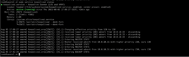

Let’s verify the status:

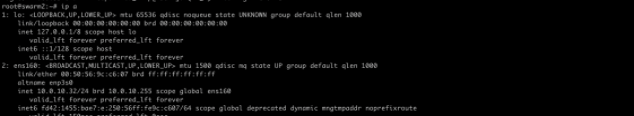

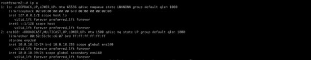

But let’s look at the local IP addresses as well:
The VIP .39 is currently assigned to the node with the highest priority, my friend swarm1.

Here’s my current swarm2:
And here again, after I cut the network on swarm1:
Ping is still fine, and all dashboards, too. That’s what I wanted to see!

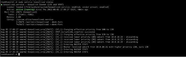

Here’s some behind-the-scene information:
At 17:39, swarm2 took over the responsibility. Now I’m enabling networking again on swarm1.
Swarm2 properly remembered its place and returned to backup state, making swarm1 automatically the master. Wunderbar.

Look at the last time stamp in the screenshot. Finally, it’s time for a beer to celebrate!

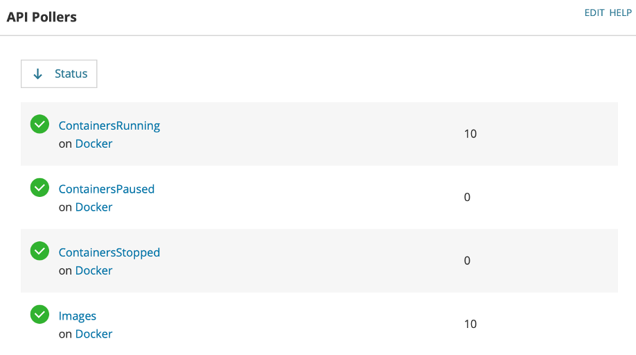

On top of that, Docker comes with an API, and “/get info” sounds like an invitation:
Yes, it’s basic, but took just two minutes. Feel free to create a nice template yourself and share with the community. Maybe I’ll do it myself as long as this project runs.
