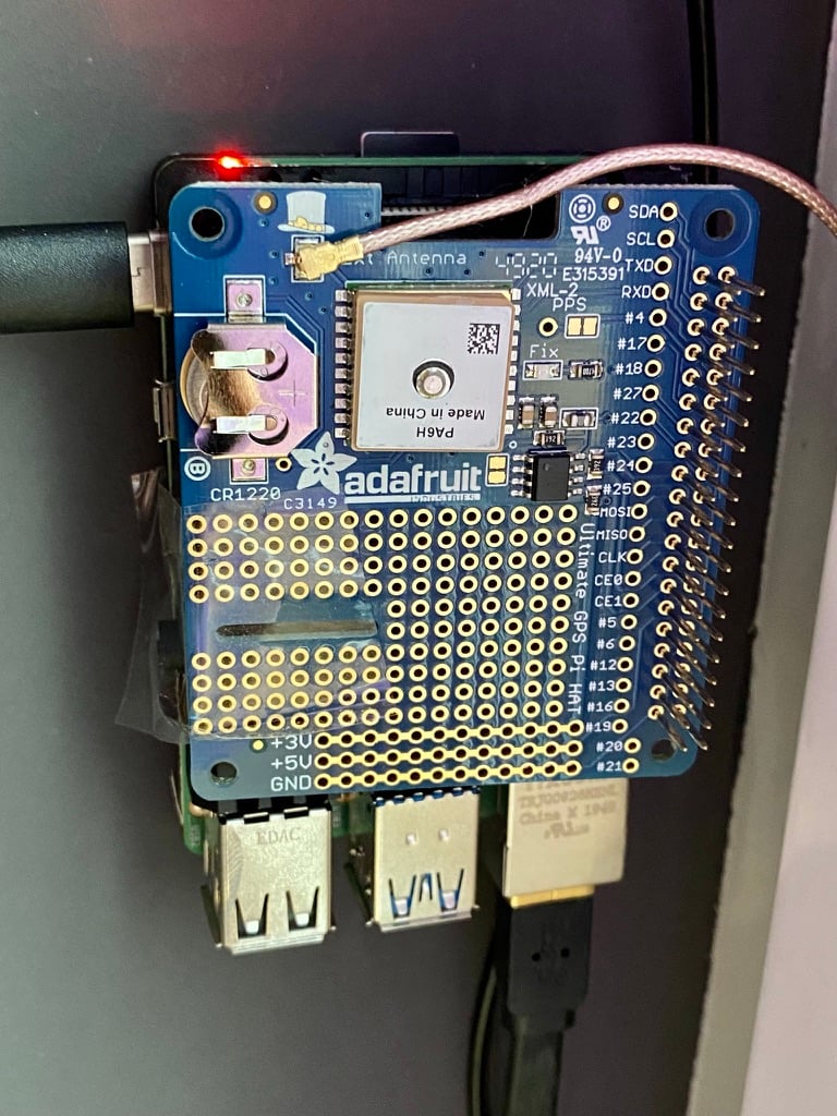

The basics are easy: you need a Raspberry Pi, a GPS antenna, and a bit of software. Nice. LDT!
(pic of the final product)

So, the next thing I bought is called “Ultimate GPS Hat,” and it does, in fact, come with a built-in battery-buffered RTC and an antenna connector. Obviously, I needed a new antenna, too.
Next, I learnt about different antenna connectors, like SMA, RP-SMA, U.FL, and others—primarily because I kept buying the wrong adapters. If anyone need spare parts, let me know.

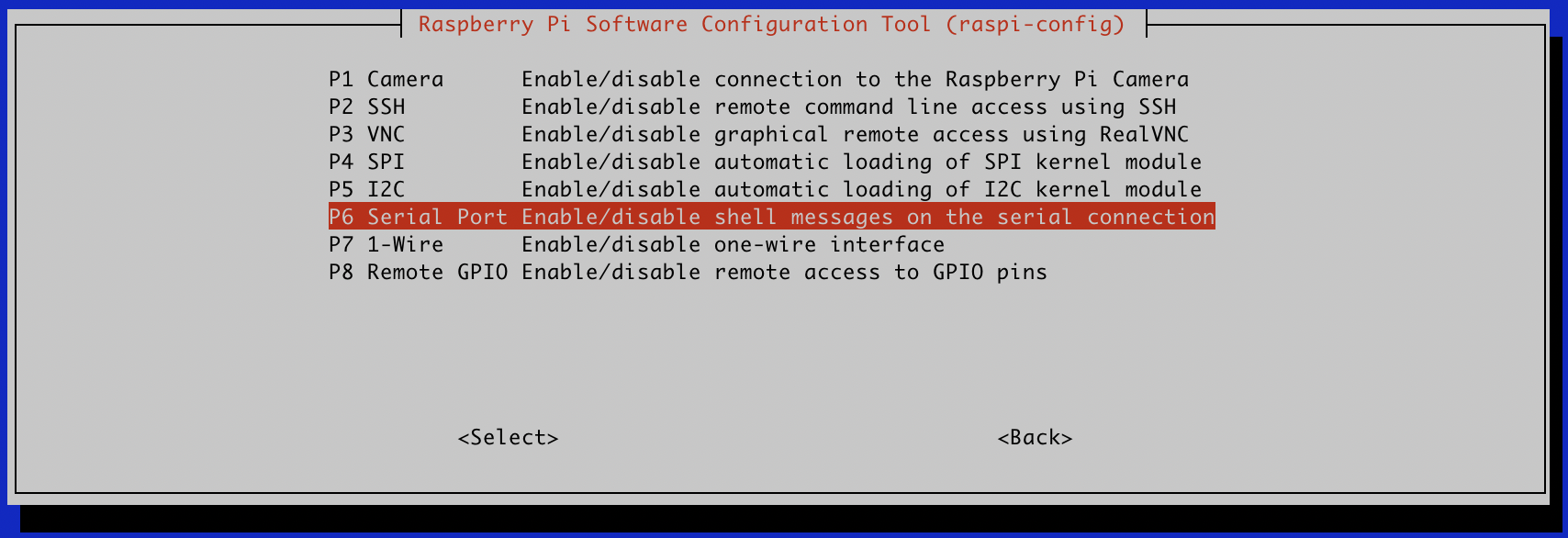

sudo raspi-config
I changed the hostname (option S4) and time zone (L2), minimised the GPU memory (P2) and extended the file system (A1) as usual, but we need an additional step here: the Serial Port (option P6) needs to be changed, too, with a “no” followed by “yes,” to make sure the GPS hat gets exclusive access.

We have a perfectly fine, prepared Raspberry, now we need to attach the hat—don’t forget to insert the battery first—and plug in the antenna, then boot it up again.

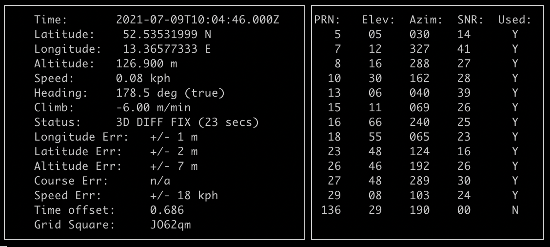

Now, the moment of truth.
Run this guy:
sudo gpsmon
For the first time, you will see loads of ,,,, between the lines, but they’ll get less and less depending on how quickly the fix comes in. With the antenna outside, it shouldn’t take more than a couple of minutes.
Another nice way to check is:
sudo cgps -s
Now you know where I’m located. Bring red wine if you ever visit me—I prep pasta!

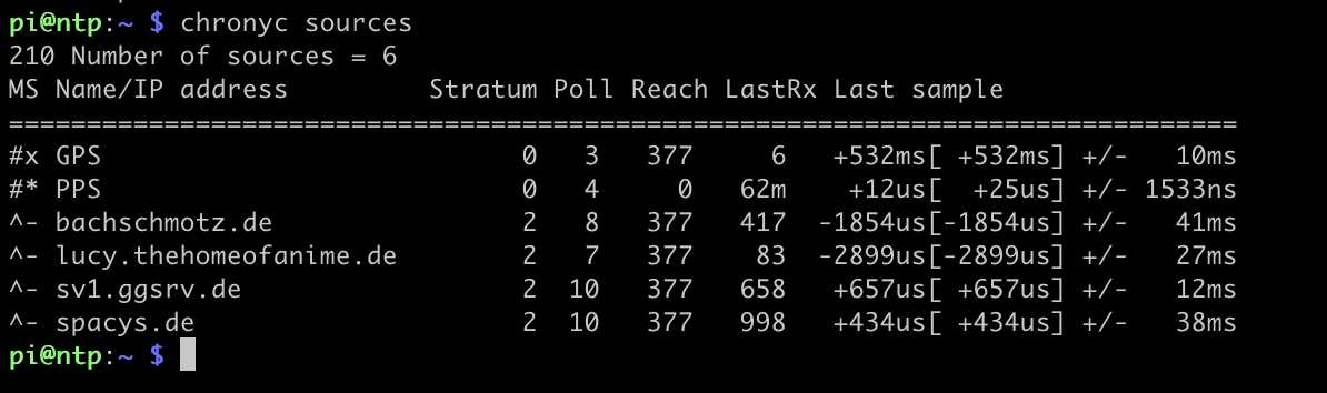

Reboot. Yes, I know. Then run:
chronyc sources
The *proves that we have a precise time source. Nanoseconds, phew! We also see the variation to the regular GPS signal, and some of the public NTP servers located in Germany.
