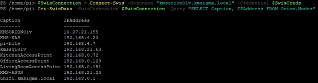

Connect to and query the Orion Server
Finally, we’ll build a connection and make a simple query to the Orion system to get some data back.
$SwisConnection = Connect-Swis -Hostname "" -Credential $SwisCreds
Get-SwisData -SwisConnection $SwisConnection -Query "SELECT Caption, IPAddress FROM Orion.Nodes"
