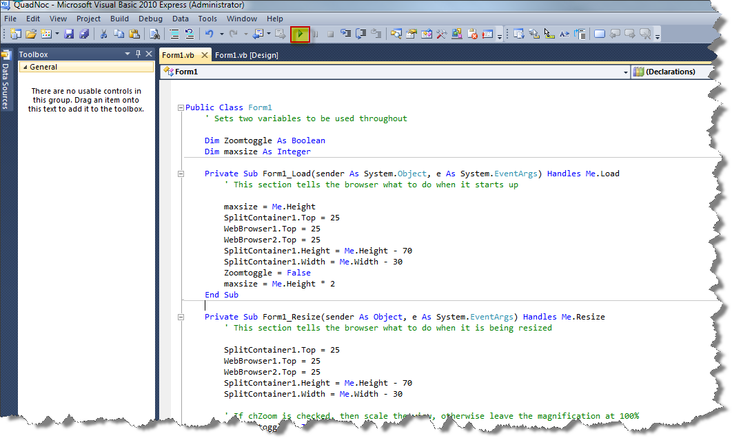

Compile the Code
Below is the code you will need to add to your Quad NOC project in Visual Basic. In your project, go to the Code view and delete everything. Next, copy and paste the code below. When done, you should have something that looks like this:
If all is well, hit the Play button, highlighted above. The browser should appear before you working as planned. If everything works, compile your code into an executable.
