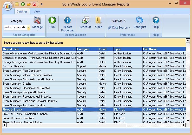

For SEM:
There are hundreds of out-of-the-box reports, many of which are categorized for FISMA specifically. These reports help address the Assess/Monitor by looking for exceptions to controls, unexpected changes or activity, or attempts to bypass controls. In the SEM Reports Console, navigate to Configure > Manage Categories, select FISMA, then click OK. To see the list, go to View > Industry Reports.
In addition, SEM includes dozens of correlation rules categorized for different compliance initiatives. From the SEM Console, navigate to Rules, and Create Rule from Template. I’d recommend starting with General Best Practice, but as we go through the actual controls you should find relevant correlation rules where real-time notifications are useful.

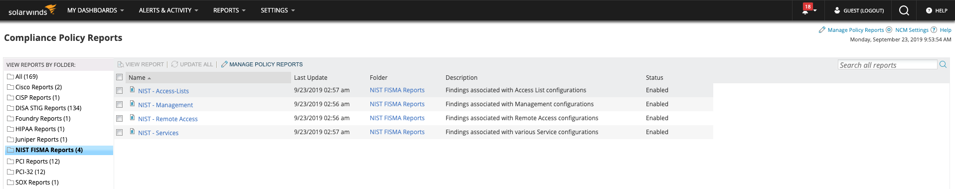

For NCM:
There are several templates included to help (starting with NCM 7.4— DISA STIG and NIST FISMA Reports Now Shipping with NCM!—earlier versions can download from the Content Exchange):
- NIST – Services: identify services exposed on network devices
- NIST – Remote Access: identify remote access enabled on network devices
- NIST – Management: identify management protocols used on network devices
- NIST – Access Lists: identify key access control lists needing to be present
In the NCM web console, under CONFIGS, then Compliance, you should see them listed under the NIST category.
