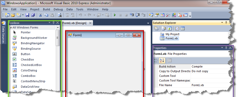

First, open Visual Basic and create a new project. (Use the picture above as a visual aid.)
Get the Form in Shape:
- Stretch the Form from the lower right-hand corner to make it as large as possible. (Select it and then grab a corner node to do this.)
- With the Form still selected, go to the Properties window to the right of the Form and find the Text property.
- Change the default text from Form1 to Quad NOC.

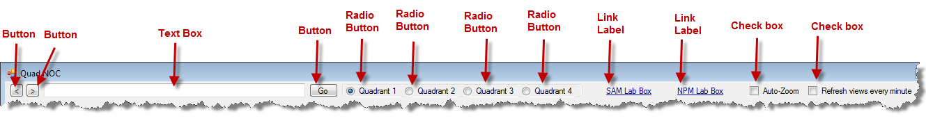

The table below explains the tools you need to put on the top of the form, as shown above. The tools used, from left to right in both the illustration above and the table below, are indicated by the header of the table.
| Tool from the Toolbox: | Button | Button | Text Box | Button | Radio Button | Radio Button | Radio Button | Radio Button | Link Label | Link Label | Check box | Check box |
| Change the Name property of this tool to: | cmdBack | cmdForward | Textbox1 | cmdGo | Q1 | Q2 | Q3 | Q4 | LinkLabel1 | LinkLabel2 | chZoom | chRefresh |
| Change the Text property to: | < | > | | Go | Quadrant 1 | Quadrant 2 | Quadrant 3 | Quadrant 4 | Your link name here | Your link name here | Auto-Zoom | Refresh views every minute. |
| Change the Anchor property to: | | | | | | | | | | | Top-Right | Top-Right |
Important: Be sure the two check boxes are not checked. If needed, change the Checked property of each to False. Also, ensure the CheckState property is set to Unchecked for both.

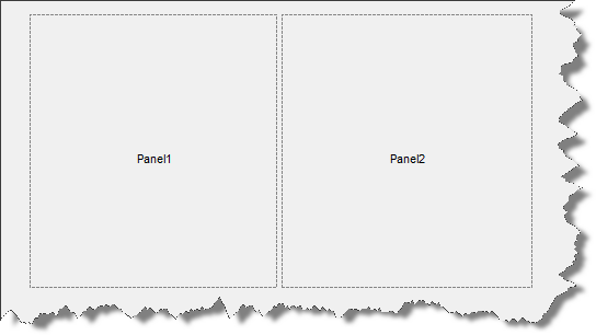

- From the Toolbox, add a SplitContainer to the center of the form. Use the default name of SplitContainer1.
- Change the Dock property from Fill to None. You should now have something that resembles the following:

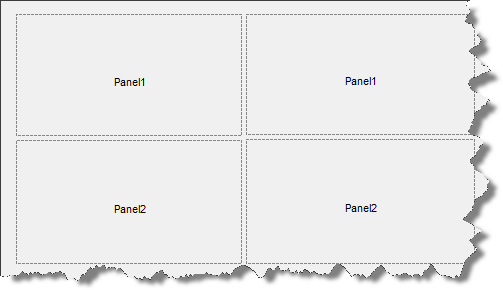

- Change the SplitterWidth property of each SplitContainer to 10. You should now have something that looks like this:
- From the Toolbox, add a webbrowser control for each of the four quadrants. Leave the default names. Place them in the order shown below:
