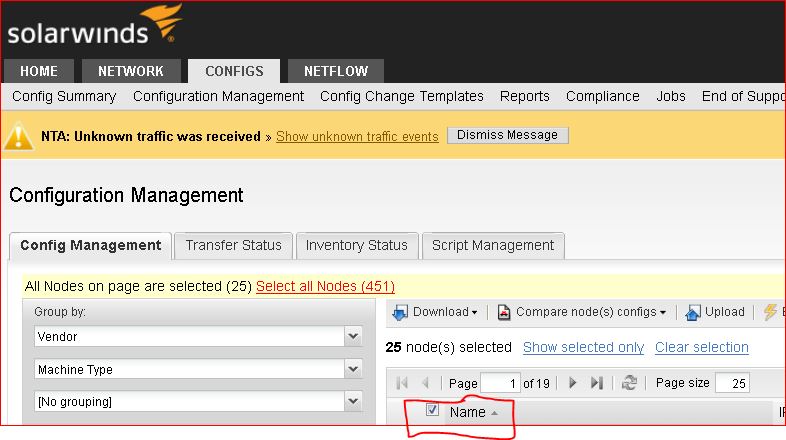

Open a web browser to you NPM page and log in.
Click on the Configs tab.
Select the Configuration Management sub heading.
Group by Vendor, then Machine Type (if you want to limit this discovery to specific machine types). I'll just pick the Cisco vendor icon grouping in the window below.
In the right window, click the empty Radio box to select all devices.

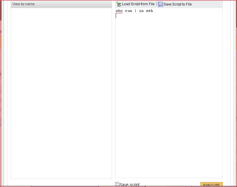

Click execute script
Type in the command you'd use to show the SSH status on a single device (e.g.: show run | in ssh)
Now click Execute in the lower right.
NCM will run that script against all selected devices, and will present an output of what it finds on a per-device basis.
