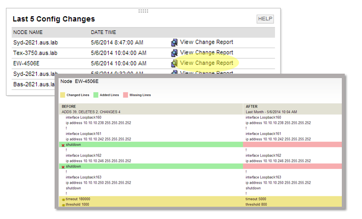

For example, consider the following scenario. NPM alerts you when a critical router interface is pegged at 90% utilization.
- You are in NCM where you instantly spot a config change alert (‘Config Change Notification’ must be pre-configured in NCM).
- The ‘Main Node Details’ page reveals the exact problem that there was a config change made recently.
- ‘Compare Configs’ to check for changes between the ‘new’ and the ‘working’ config. Changes are highlighted in a block on the config code (changes could be - in the interface speed or QoS policy or anything else).
- Select the device from the ‘Configuration Management’ page to view configuration and node details.
- Click on the ‘Upload’ button to select the right configuration file revert changes made earlier
- Click ‘Upload’ to push the last-know-good config.
- Click ‘Transfer Status’ to view status of upload and problem solved!

Integrated solutions are hard, but monitoring configuration changes and recording this information is extremely useful to determine if a configuration change is the cause of a network outage. So, instead of just collecting device configuration (backup) at a specific time each day, you can configure NCM to alert you every time there is a config change. This means you can immediately determine if a reported issue coincides with a configuration change and if it did, push the previous configuration to replace the new one and Bob’s your Uncle – the network is back!
