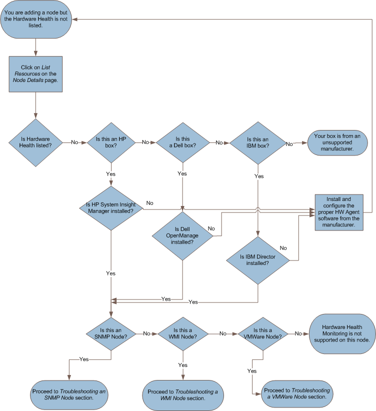

If the following conditions cannot be met, the Hardware Health resources will not be displayed. To monitor hardware in SAM, the following must be true:

Hardware Troubleshooting Flowchart

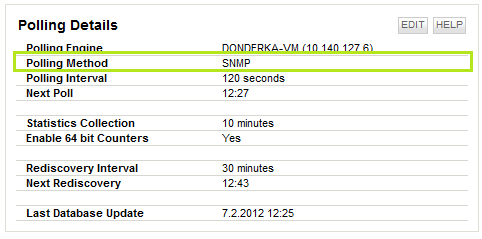

- Verify the node was successfully added using SNMP.

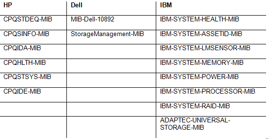

3. Determine if SNMP responds for the proper OID. Below are the correct OIDS for each vendor:
For HP: 1.3.6.1.4.1.232.2.2.2.1.0
For Dell: 1.3.6.1.4.1.674.10892.1.300.10.1.8.1
For IBM: 1.3.6.1.4.1.2.6.159.1.1.60.3.1

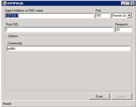

If you do not have a tool for checking OIDs on the remote server, you can create an SNMP walk by using the SNMPWalk.exe installed with SAM, normally located at C:\Program Files (x86)\SolarWinds\Orion\SnmpWalk.exe. SNMPWalk.exe will be used in this demonstration.
Using SNMPWalk.exe:
- Start SNMPWalk.exe and type in the IP address of the remote server and the community string for SNMP.
- Click Scan.
- After completing the scan, save the SNMP walk in a text file.
- Open the text file and manually search for the OIDs.
- If the Remote Server does not respond on this OID, the Hardware Monitoring Agent software may not be properly configured. Check to see if the Hardware Monitoring Agent software has imported the correct MIBs as outlined in the following table.

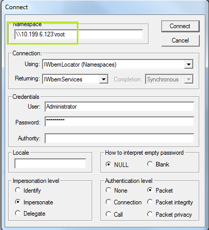

- Open wbemtest.exe, usually located at C:\Windows\System32\wbem\wbemtest.exe.
- Connect from the problematic node (either the SAM server or the additional poller server) to the remote server using wbemtest.exe.
- Click Connect.
- In the Namespace field enter:
For IBM and HP enter: \\RemoteServerIpAddress\root
For Dell enter: \\RemoteServerIpAddress\root\cimv2
5. Enter Administrator credentials
6. Click Connect.

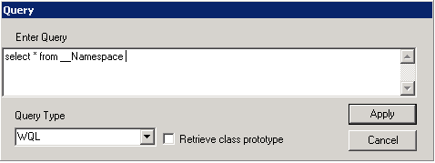

7. Once connected, click Query… from the main screen. The Query dialog appears.
8. Enter: select * from __Namespace
Replace Namespace with the following:
- For HP nodes, replace Namespace with HPQ
- For Dell nodes replace Namespace with Dell
- For IBM nodes replace Namespace with IBMSD

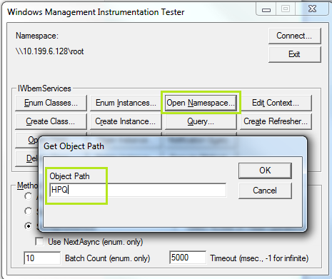

9. If the proper Namespace is found, connect to this Namespace.
- \\RemoteServerIpAddress\root\IBMSD for IBM.
- \\RemoteServerIpAddress\root\HPQ for HP.
- \\RemoteServerIpAddress\root\cimv2\Dell for Dell.
10. Run a Query for specific information.

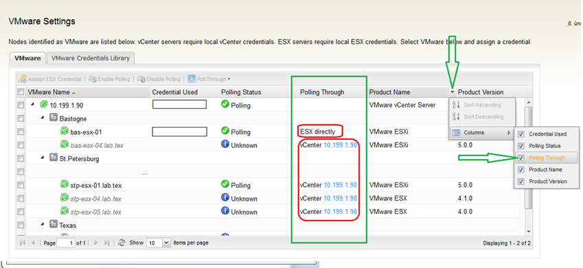

VMWare nodes can be polled for Hardware information either through the vCenter or directly by using the CIM protocol. Polling through the vCenter uses VMWare's native API interface. Polling the ESX server directly uses the CIM protocol to get Hardware information.
To determine if a node is polled through the vCenter or directly:
- From the web console, navigate to Settings > Virtualization Settings
- Listed will be table of all the currently polled VMWare nodes. This table contains the Polling Through column. Note: This column may be hidden. If the column is hidden, unhide it by clicking the dropdown menu of an adjacent column and check the Polling Through option:
- Use the illustration below to determine how your VMWare is being polled.
