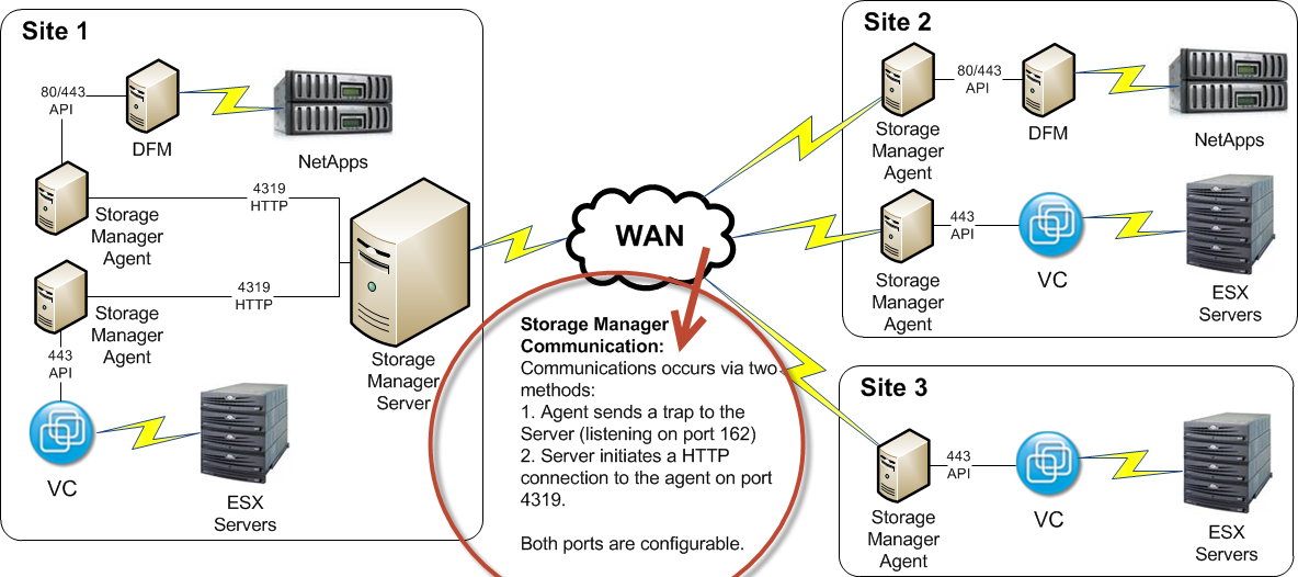

The Storage Manager Collector service gathers data from the Storage Manager Agent using HTTP and Traps. The Storage Manager Agent sends a Trap to the Server when the data is ready. When the server receives the Trap, it will connect to the Agent using HTTP and submit a GET command to collect the data. By default, the Server receives a Trap from the Agent about once every hour. If communication between the Collector service and the agent is blocked, the data Is not collected. Below is a diagram to help visualize how Storage Manager uses HTTP and Traps:
